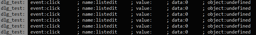

How can I determine which value was clicked? The msg object doesn't seem to provide that information.
msg.index
That was it. Thanks!

When the List Edit Control has its Read-Only property set to false, clicking an item starts editing it. That means you can't click items for other purposes anymore. Could you add a way to avoid that? One option could be that holding Ctrl while clicking triggers the click event instead of starting edit mode.
Edit: The 2nd was a unrelated situation.
Not sure I understand sorry, can you provide an example?
A List Edit control, with Read-Only property set to True :
  • It means you can't add values or edit existing ones.
  • Entries are clickable like buttons. And when you click one, a click event is registered.
With the Read-Only property set to False:
  • You can add and edit entries inline.
  • Clicking an entry enters edit mode; when you finish editing, an editchange event is registered.
  • No click event is registered when clicking an entry (technically clicking enters edit mode).
What I suggested is that, to have an in-between state when Read-Only is False (one where you can add/edit entries but existing ones can also be clicked, and therefore, you could actually do something with them), so that an entry can behave both like a button and like an editable field. One idea would be that if you click an entry while holding Ctrl, avoids entering edit mode and behaves like a button, triggering a click event instead of entering edit mode.
