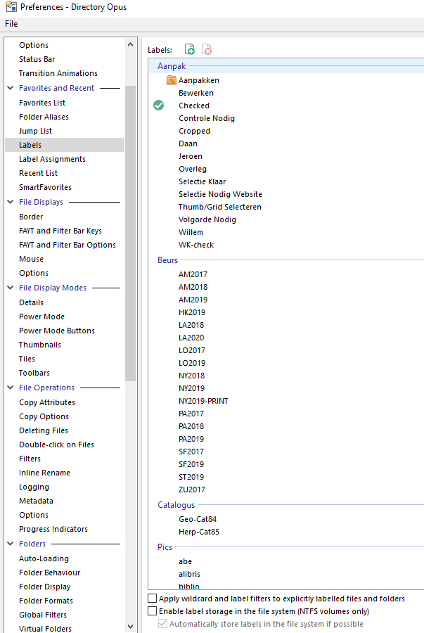

So first the labelcategories I use.

  • I have renamed a long time ago the labelcategory status to zz-Native. I hope that does not confuse the labelsystem.
  • I think my Label Assignments database is quite big, when I open it in Preferences, the program needs some time to show.
  • I am not using label storage in the file system
  • We have several licenses of Directory Opus and on the other computers this label issue also occures, but, we all use the same config file (backup/restore). I can reset 1 Directory Opus installation to test this label issue…, but I hope to avoid that.
  • I can send you my config file
I can reproduce what you're seeing now.
It's partly due to Preferences / Favorites and Recent / Labels / Enable label storage in the file system (NTFS volumes only) and the option below it both being turned off.
That's also why opening the Preferences labels list is slow for you, since it has to list all those files/folders with labels.
But there are sometimes good reasons for having those settings turned off. It depends how you want the labels to work (and also how other software you use overwrites files that are edited). So keeping it off might still make sense, unless there wasn't a particular reason for it to be off. (It's on by default, at least in new configs.)
We'll look into why the multi-line commands aren't working correctly in this situation, since they should work no matter which way around the setting is.
