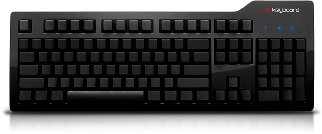

This is my keyboard, funnily enough I can always find the letter keys but have to think hard to find Insert :slight_smile:
If it is standard layout then it is the upper left of the six keys above the arrows.
But the strange thing is that I barely remember (or care) where anything is when I see it, but my hands know.
Just for comparison, here's mine:
Its a gaming keyboard, but it is perfect for coding.
But what are all those symbols on the keys??? :slight_smile:
ROFL.
Btw, your keyboard seems perfect to train writing without looking down.
But when you see my keyboard I'm sure you can relate to the "most crowded part of the keyboard" :slight_smile:
