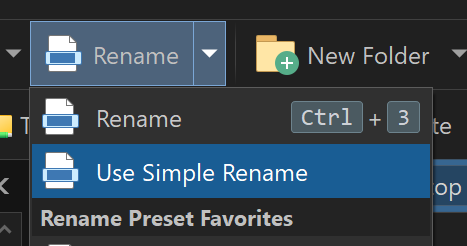

Normally, you just select some files and click the Rename button.
If that opens the simple rename dialog instead, it's probably because this option in the button's menu has been turned on:
If so, click that option again to turn it off.
@disablenosel

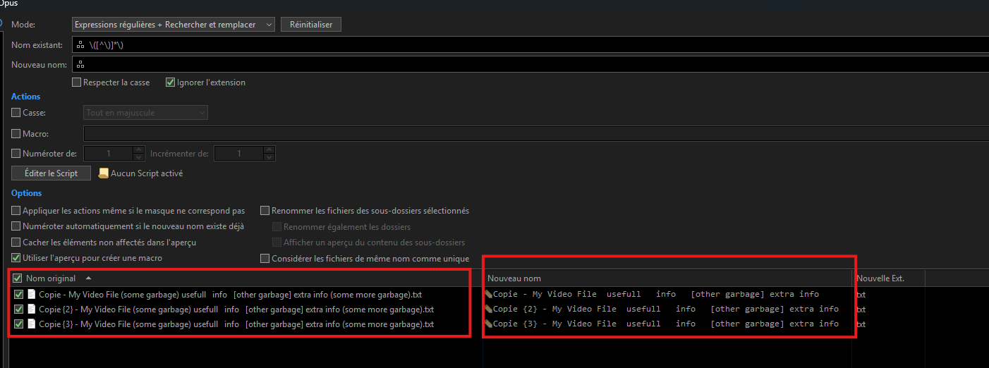

Rename ADVANCED
@nodeselect
Regex & Replace rename:
  • Existing : \([^\)]*\)
  • New: leave it empty

Regexp explanation:
  • \( : Start with a parenthese
  • [^\)] : Everything but a closing parenthese
  • *: any number of time (including 0)
  • \): end with closing parenthese
Since it's regexp and replace, all pattern matching that sequence in the filename will be replaced by nothing.

Put all this in a button, this should do the trick:
@nodeselect
Rename FINDREP REGEXP PATTERN="\([^\)]*\)" TO="" IGNOREEXT
Rename FINDREP REGEXP PATTERN="\[[^\])]*\]" TO="" IGNOREEXT
Rename FINDREP REGEXP PATTERN=" [ ]+" TO=" " IGNOREEXT
Rename FINDREP REGEXP PATTERN=" $" TO="" IGNOREEXT
First line eliminates groups of parentheses and everything in between.
Second line does the same for brackets.
Third line eliminates every redudant spaces (any number of spaces into a single one).
Fourth and last eliminates any trailing space at the end.

Remaining spaces
Since the regexp is only removing parentheses and what's inside of them, if there was a space before and/or one after, the space(s) remain.
So a name like "Some Name (garbage).ext" turns into "Some Name .ext"
if you applied on Test 3 (Official Video) [4K] (128kbit_AAC): parentheses removal will get you the space after Test 3, and brackets removal wiil get you the two before and after [4K]
Solutions: either take into consideration the space before to remove it (regexp starts with \s* or \s to remove mutliple or single space), or, as I did, process name afterwards in a second substitution to remove redudant spaces and trailing space.

Coding explanation
Not really. They are defining a group of allowed characters.
Since inside the brackets, it starts with ^, it becomes forbidden characters.
If we did \(.*\), it would suppress everything between the first opening parenthese and the last closing one.
The difference could be seen on a file name such as: "My Video (some garbage) more info (some more garbage).ext".
First solution renames into: "My Video more info .ext"
Second solution renames into: "My Video .ext"
