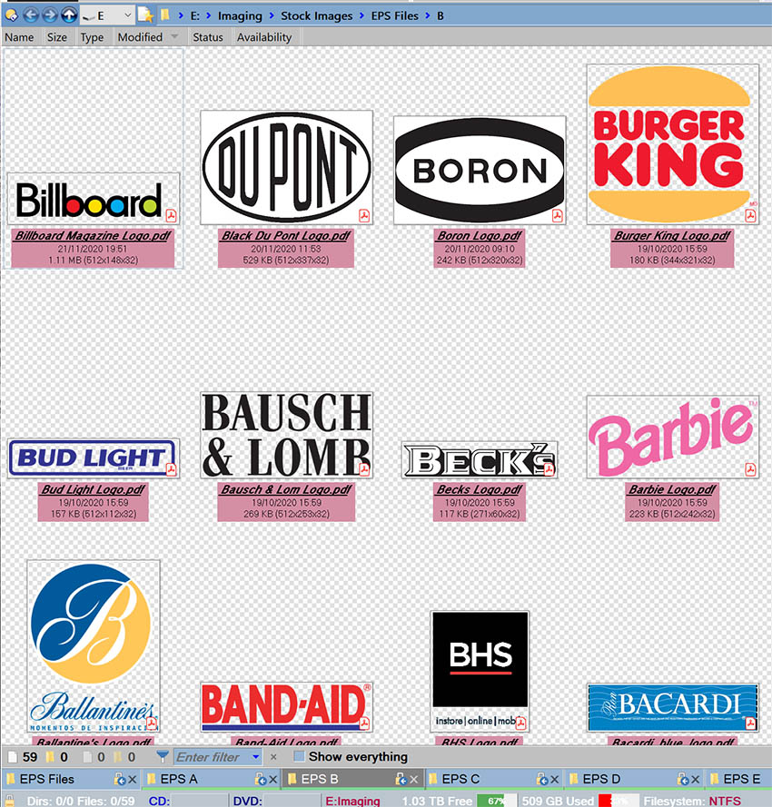

use this to create background for Lister:
checker.zip (2.3 KB)
All you need then is a properly configured transparent thumbnailer (Mystic Thumbs is the one I use but there are others) and you will see the white from the space.
You only need that if you want transparent pdf thumbnails. Things like PNG and GIF are built in to Opus with transparency support.

Do not want to take anything away from Opus at all, but transparent PDFs are vital for me. Will Opus cope natively with transparent PSD and LZW compressed Tiff files?
