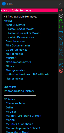

You can also use the dialog to move files to a destination instead. Example:
AltTreeSelect MAXLEV=2 MOVETO
In this case, I did not even specify a STARTFOL, which means: the dialog shows the current folder. Even that is useful, as you may often wish to move files to subfolders of your current directory. To move files to other locations, you need to use a button with a STARTFOL argument - and the dialog will still pick up file(s) you selected in an entirely different location - which makes the tool versatile.

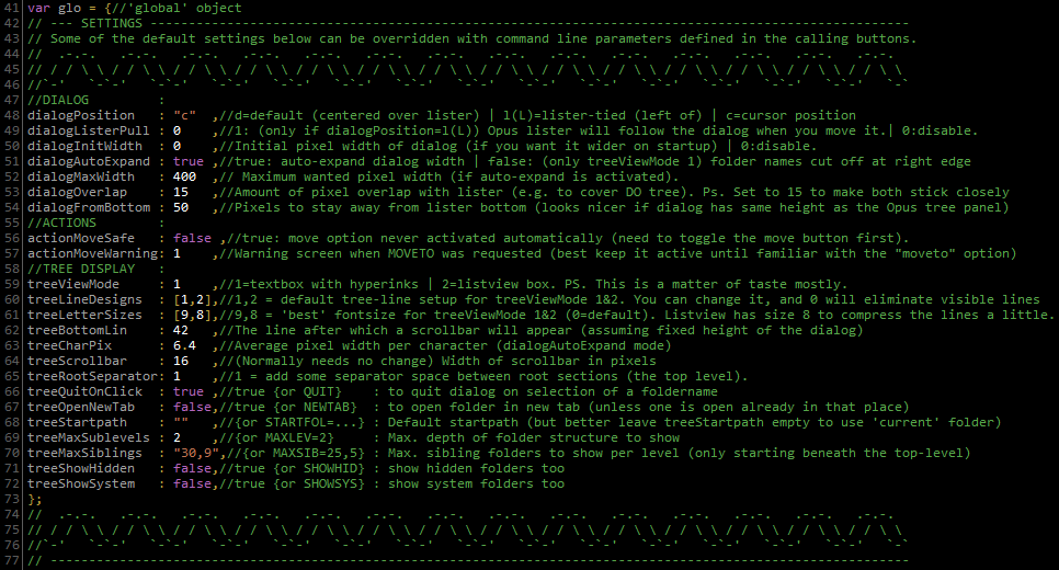

There are a number of default parameters in the script which you can tune as well. When they are the same function as the button arguments (a.k.a. command line arguments), the latter will override the defaults. Some values that can be changed with buttons in the dialog, will be kept in memory (so they are remembered when you close the dialog) - those too will be overridden by any button arguments. There is one exception: when you “pin” the dialog with the pin button, it will not be overridden by the QUIT command argument. When you pin your dialog, it’s arguably for a reason which shouldn’t be ignored.

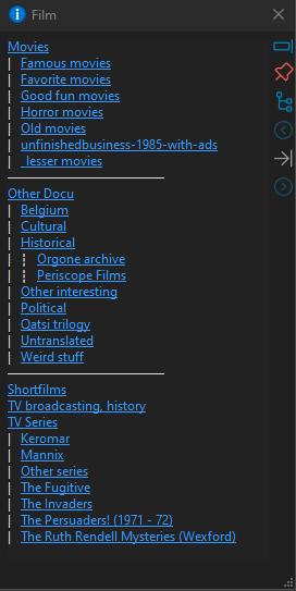

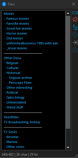

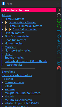

Furthermore, the dialog uses two display modes for the (partial) folder tree:
  • markup text, showing “hyperlinks” to click on: this was the original implementation. It is dense and presents well, but slows down quickly when there’s lots of folders.
  • listview control: always fast, but less dense (which is why I used a slightly smaller lettertype for that one - but you can adapt this). This is the current standard setting in the script. (it’s one of the things you can toggle with a dialog button - because its fun to do).
Markup control vs. Listview:
OR
PS. I do wish I could set the background color of the entire listview (on the right) to the same color of the dialog, or to transparent.

The parameters are sufficiently documented in the script:

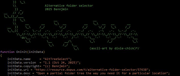

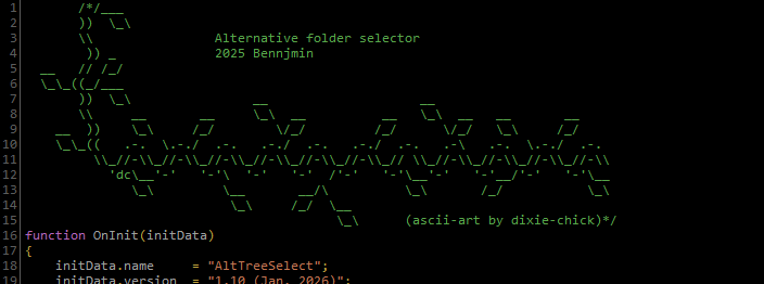

Import the script via Settings > Install Script:
AltTreeSelect.opusscriptinstall (39.7 KB)
