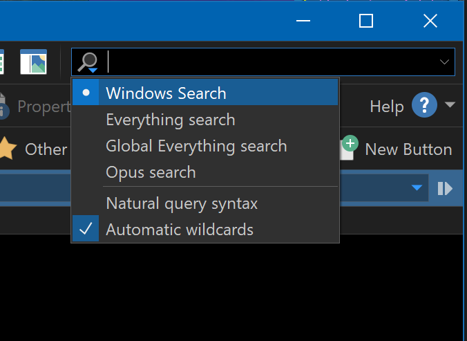

Click on the magnifier icon in the searchfield: it opens a menu where you can select the search engine.
Seems Directory Opus doesnt have any "Windows search" option.
Thanks for that. Didnt think of the search field up at the right, I only thought about the lower search field. But the lower search field doesnt support AND or OR operators when that "Windows search" is selected.

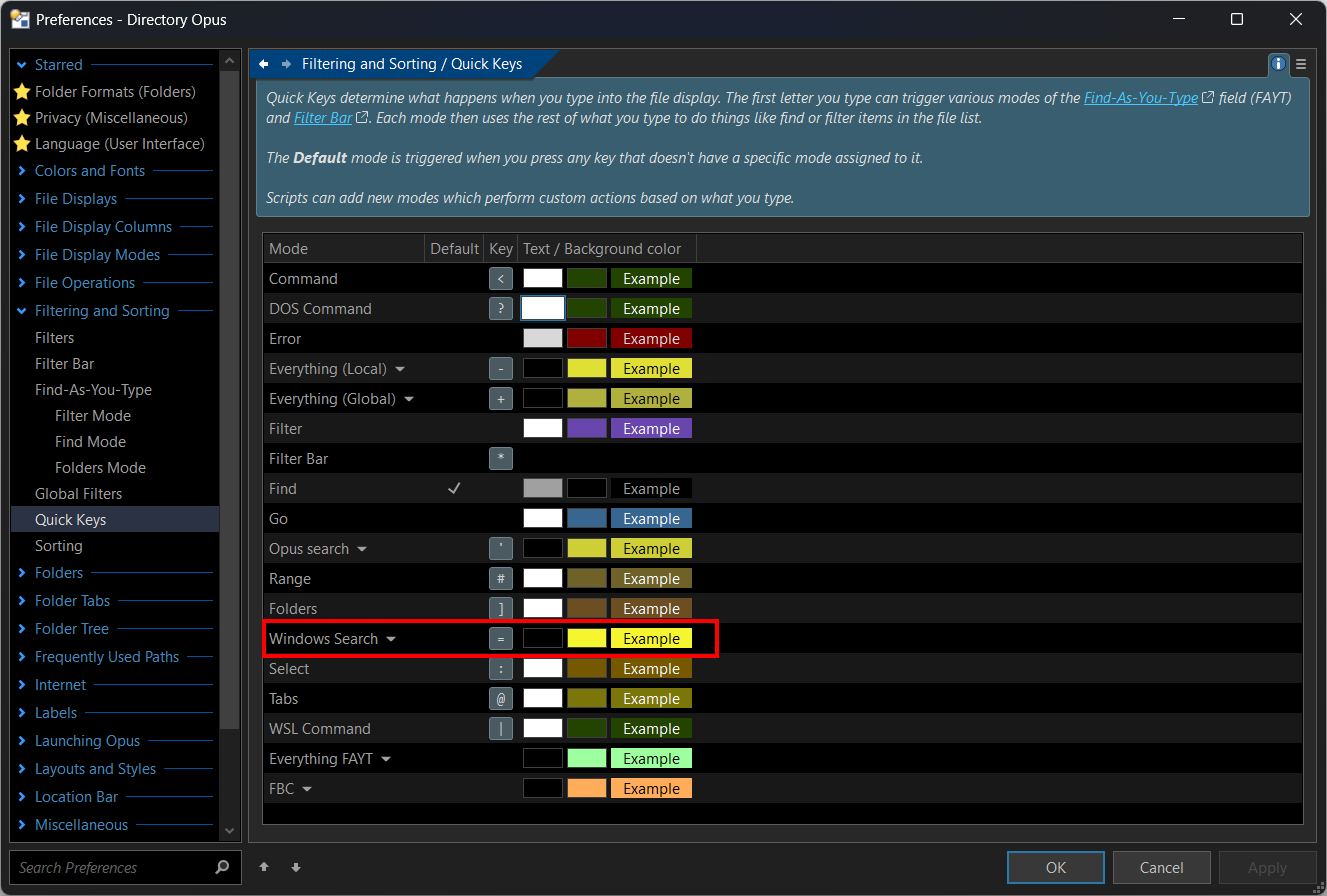

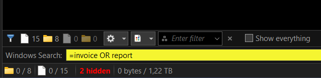

Entering =invoice OR report in the file display seems to be the quickest way.
Which is also the same thing as entering invoice OR report into the Search Field when it's in Windows Search mode.
(Doing it Hardkorn's way means you don't have to have the Search Field taking up space, since the Find-As-You-Type field appears and hides itself automatically when you start typing or stop using it.)
