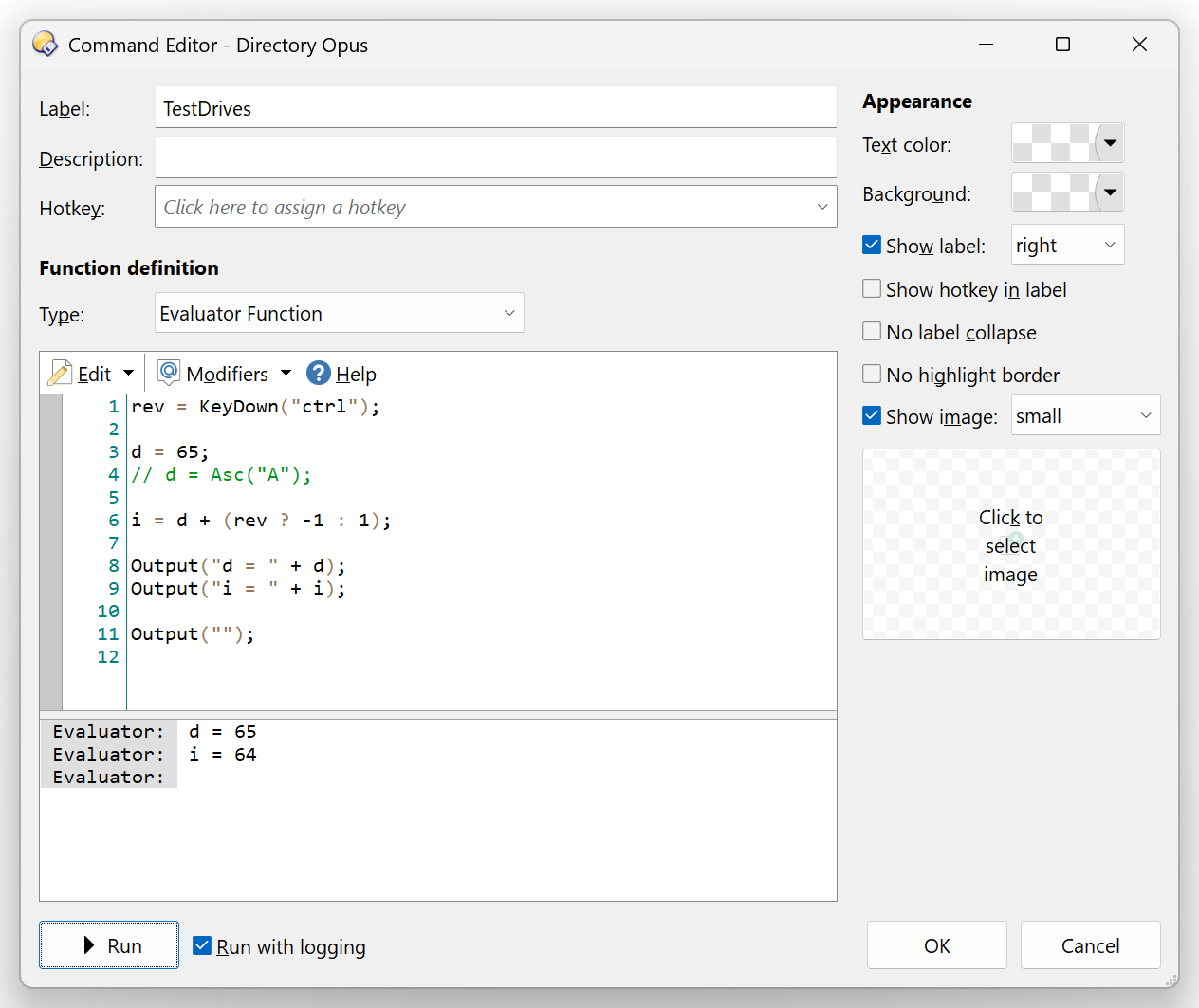

This Evaluator function (unsurprisingly) prints 65 and 66 or - if we press Ctrl - 65 and 64:
rev = KeyDown("ctrl");
d = 65;
// d = Asc("A");
i = d + (rev ? -1 : 1);
Output("d = " + d);
Output("i = " + i);
Output("");

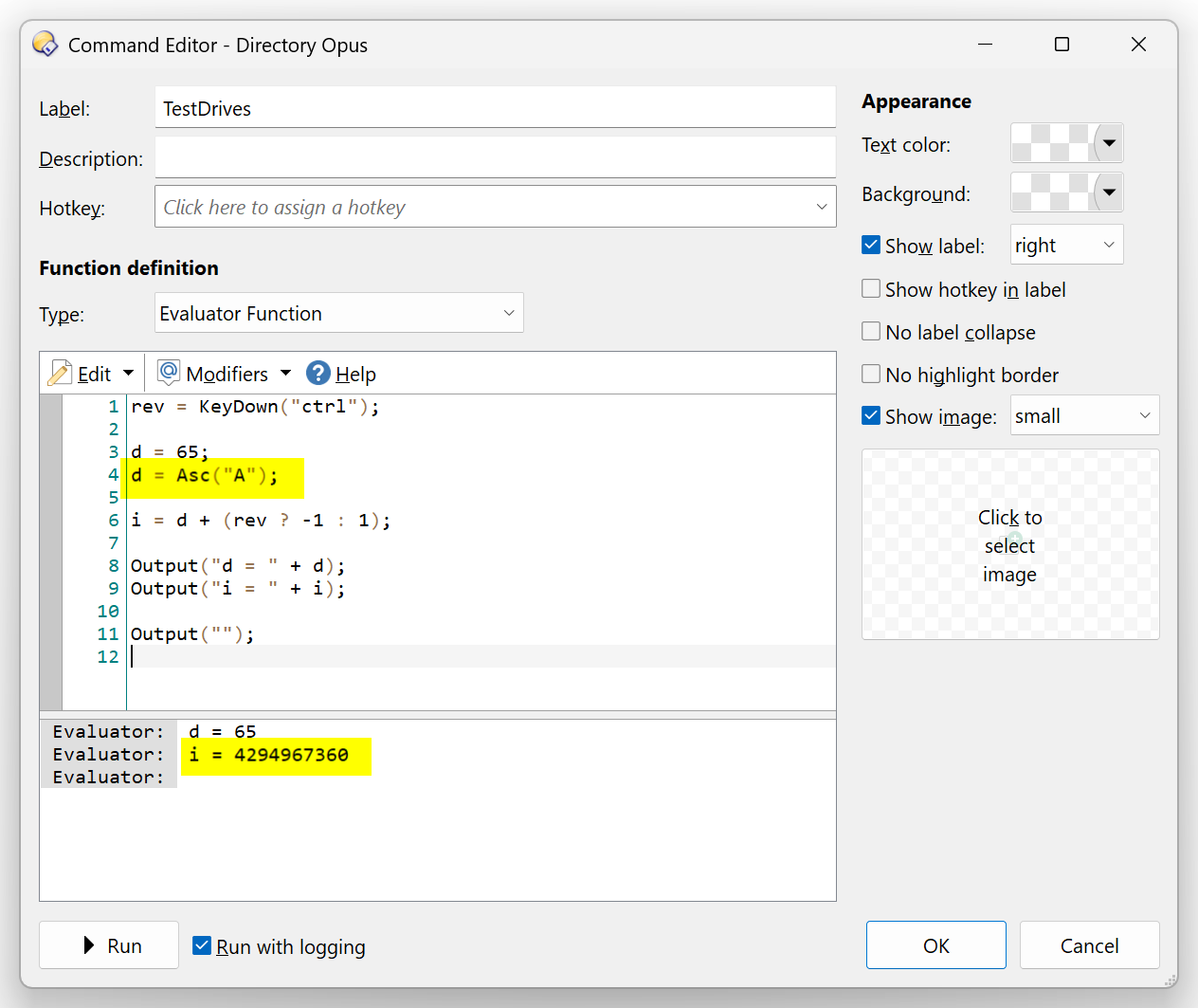

Now look what happens if we use Asc() to define d and press Ctrl:
Not something we need so close to the finals :wink:
Update: Looks like Asc() is the main culprit here. Forcing a conversion to integer seems to fix the problem:
d = Asc("A") As int;
Using if-else instead of ternary will work for a while and then fail if Asc() is not converted to int.
