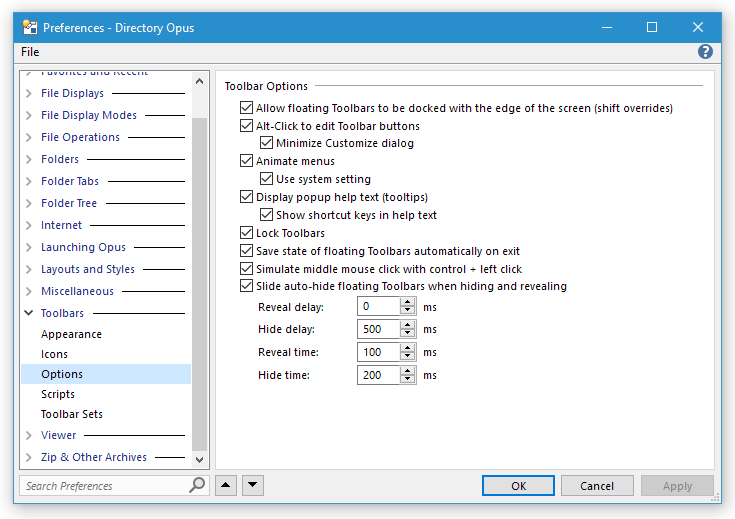

You can control the animation speed of the slide in and slide out: Preferences / Toolbars / Options / Slide auto-hide floating Toolbars when hiding and revealing.
It's great to control the speed of the animation, guess I was looking for a way to control the actual trigger speed. If you try it, you'll notice it triggers instantly which is where it gets in the way a little for me. Maybe something to consider for a future update...probably doesn't affect that many people I know. Thanks for the help.
This post is a little old, but is there any chance that this function might every get added to Opus? The lack of a delay is SOOOO incredibly frustrating!!! I've tried orienting a tool bar along the top of a screen, but moving the mouse to move, minimize or close a window frequently triggers the slideout. I've also tried orienting the tool bar along the right side of the screen, but using a window's scroll bar frequently triggers the slideout. The left side of the screen doesn't really work with my monitor setup.
A short delay in triggering the slideout would would completely solve the issue. The existing "delay" settings mentioned above really aren't delays. In actuality they are reveal and hide speed settings.
Here's to hoping!! :slight_smile:
Opus 12.3
We've added this for the next update.
