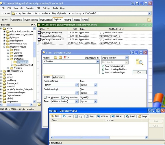

I'm not catching on how to use the find panel... I've used many find tools over the years but am not finding known files with this one.
I've included a screen grab showing the panel setup.
My objective there is to find several file or directory names containing the string `candy'
I know there are three plugins in that adobe directory with `candy' in there names. Other find tools go right to them but somehow, I come up blank using the find panel of Dopus.
What am I doing wrong here:

Using the Simple mode, searching for candy should be the same as candy so it shouldn't be that.
[ol][li]Is there anything (e.g. some spaces) in the Containing Text field that might be messing things up?
[/li]
[li]Can you show a screenshot with one of the files you think should be found?[/li][/ol]
By the way, that is the old Find Window. The newer Find Panel is better: Tools -> Find Panel.

Yes... its attached to this post.
By the way a tool called FileLocator I use, finds the files using string `candy' with no problem.
The windows search 4 tool finds the expected files as well.

This attachment shows top level (W:\adobe) being searched, with the expected files unfolded for screen shot.
Also another search using `candy' and the negative result.

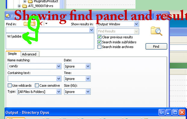

Problem seems simple if I am not wrong.
You did not actually ADD the folder to the folders dopus is searching in.
Click on the "folder" icon so the screenshot looks like mine :slight_smile:
Did it work??????
W:\adobe needs to be put down into the "other window" like in my screenshot :slight_smile:
[quote="Ironhand"]Problem seems simple if I am not wrong.
You did not actually ADD the folder to the folders dopus is searching in.[/quote]
It shouldn't matter whether or not the folder is in the list. You only really need to use the list when searching multiple folders.
You are right! Strange. I actually had the same problem like you and was very puzzled. Dopus is not intuitive here.
But I played around and suddently it worked. I thought is was that but it wasn't. I've been living on a lie for year now!
Anyway - I'll try to reproduce the problem again and check. I hope I figure something out :slight_smile:
