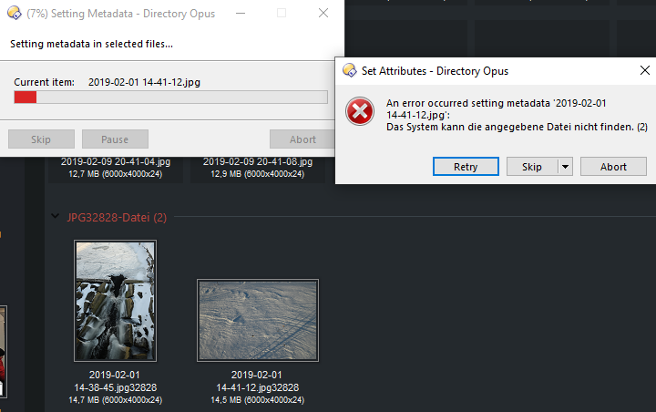

After testing my batch timeshift script (https://resource.dopus.com/t/dialog-button-for-batch-timeshifting-picture-metadata-with-syntax-check/38723/2) successfully im now running into problems in a production environment (batching ~2000 files). When starting the timeshift the SetAttr command is running into problems.
  • One is "metadata parsing error" but "batching" the single file works flawlessly.
  • The second is a "file not found". It seems that DOpus is renaming the file where SetAttr should be applied (a numeric is attached to the extension). Then the command fails with "system cannot find the file". As you can see in the image below the file which is not found is existent but with another extension.
