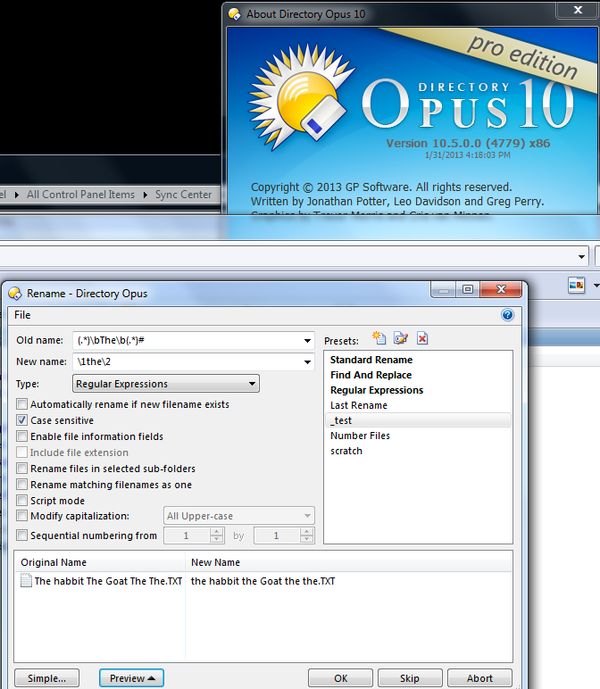

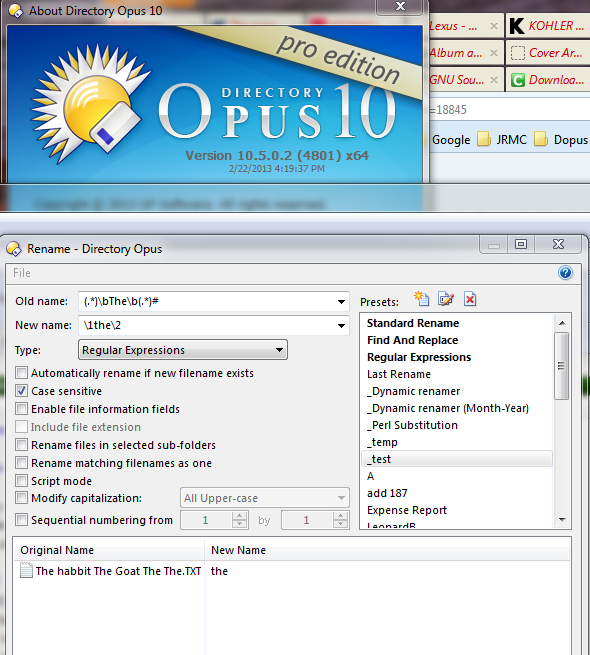

Take a look at the two screenshots comparing 10.5.0.0 vs. 10.5.0.2. Both DOpus versions are using TR1 style regex.
