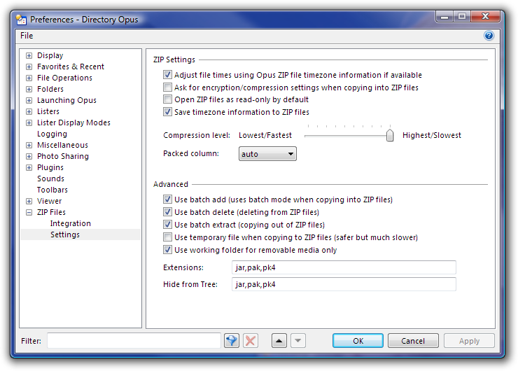

A screenshot of my Zip settings is below in case any are different and you want to try using the same settings that work for me.
Question: If you copy the zip file, does that also take a long time? If so then it's almost certainly due to an anti-virus scanner looking inside the zip archive after it is created.

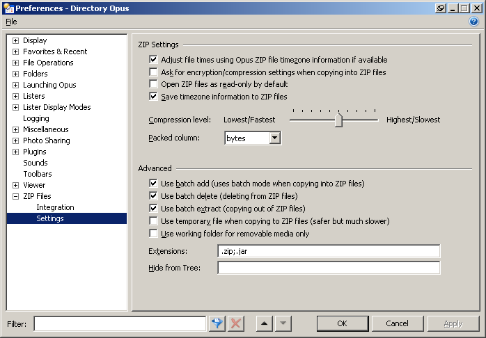

Are your zip settings the same as shown in the screenshot above?

The obvious difference is the 'Use working folder for removable media only' option. Try turning that on.
I saw the difference but from the manual I judged that it's only relevant for removable drives. Did I misunderstood the help.
Nevertheless I turned the option on, but I didn't notice a major difference.

@leo: I tried exactly your ZIP settings and the effect is the same: Problem is still there. My anti-virus scanner was deactivated, so it's not causing the strange effect. If I copy the ZIP file, everything is fine and fast. No problem then, even if the AV scanner is active.
@jon: "Use working folder for removable media only" doesn't make any difference here either.
