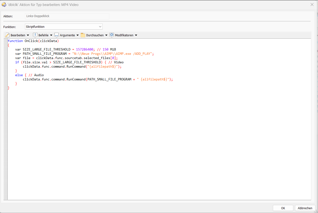

Thanks, bytespiller. I keep getting some error messages. Note, that i have changed the size considerably, because i have lots of very large MP4 audio files, maybe some even being larger than 150MB, for example whole albums. The same happens, when i do not change the size.

That would have been embarrassing. But ... once i double click the file, even it wasn't selected, i would select it by the double click, wouldn't i? Very strange. Does it work for you, using your own players? I even tried to change it to VLC (with Leo's modified lines), but then i get this:
I tested a few MP4 movie files, in different locations, NTFS, but i get the same result, even after the changes you suggested. And, what i just tested, the music MP4s also throw the same error. Just to be sure, this is the current code. The path to AIMP is also correct, as i fetched it using Opus. Changing the player to VLC, however, brought up a different error code, which might be a hint. VLC is, by the way, installed on C:\program files, standard way, whereas AIMP is on my other SSD. But that shouldn't really make a difference.

Ah, try changing the [0] to (0) - Does that fix it?
Yes, that did it so far, music playback works now :+1:. However, AIMP seems to insist also taking the larger video files (which should be opened in 5KPlayer). Maybe the script should explicitely tell Opus to open this path:
