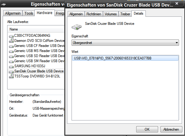

To restart a specific device you'll need to know the "device instance ID" of the device which you can find this way:
Right-click the device=>Properties=>Hardware=>doubleclick your device=>Details=>choose "Superior" (german: Übergeordnet).
For my Sandisk Stick the command looks like this:
RestartSrDev USB\VID_0781&PID_5567\200601653318CEA077BB
To restart all "safely removed" devices currently plugged in to you Computer you can simply use this:
RestartSrDev *
