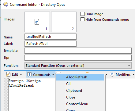

Is there a way for me to call the scripts "InitColumns" method from a button on the toolbar? I've tried to create a new internal command "ToolRefresh" using the following code - but it hasn't worked and I'm not convinced this is the best way, despite it showing up in the command editor 'command' dropdown.

Thank you Leo. I do have logging at the start of all functions so I know when they've been fired. Here is some more information and some stripped out code (notably the csv to array function is missing).
The command which powers the 'refresh manually' button. Note that the command 'AToolRefresh' has made it into the command dropdown
This output shows the tool initialising when enabled, then the columns being build after an F5. This is followed by an error when the above button is pressed.

 11/02/2018 09:03  Error at line 2, position 1
 11/02/2018 09:03  'AToolRefresh' is undefined (0x800a1391)

Take out the first line from the command button (@script JScript).
Thank you Jon! I think that got added in when I switched the 'function' of the command over from 'Script' and I didn't know any better to remove it.
Frustrating to know I was so close.
