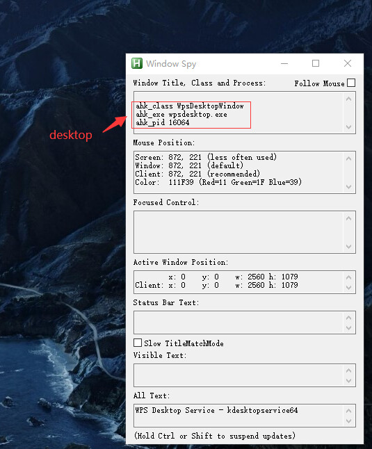

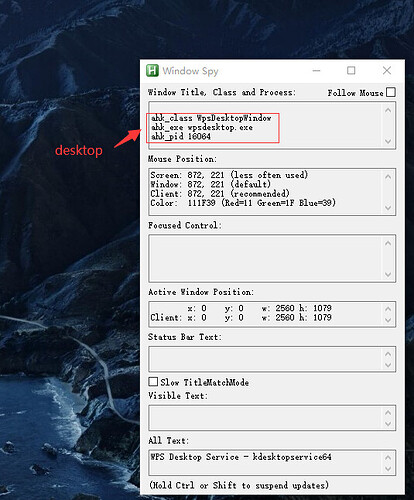

It also has the ability to double-click on the desktop to hide the desktop icon, personal feelings and double-click on the desktop to launch Dopus conflict, so it disables the double-click on the desktop to hide the desktop icon, and now double-click on the desktop can not launch Dopus, unless I quit the desktop software, and after testing and troubleshooting, I found that the desktop software took over the desktop process, and now my desktop process becomeswpsdesktop.exe,the class name becomesWpsDesktopWindow
Can you add a desktop process to the "double click desktop to open Dopus" option
In this way, I add the desktop process to the options without affecting the startup of Dopus by double-clicking the desktop.
