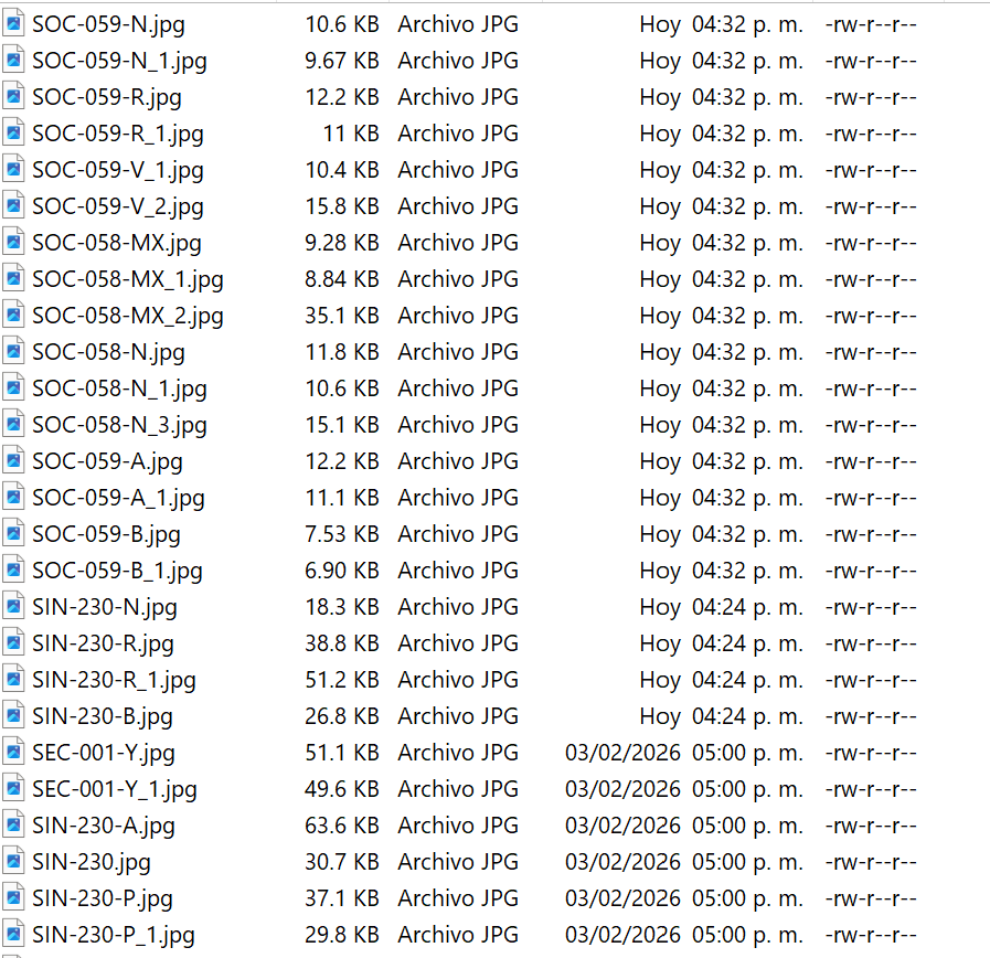

Can not see file on ftp

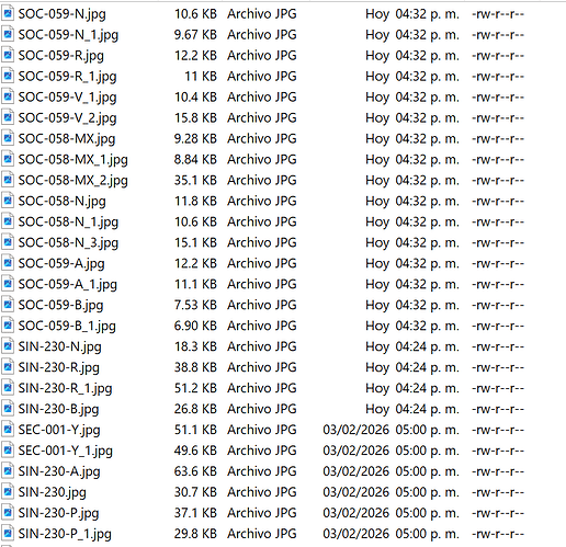

On this particular folder on my hosting, I can not see any other file but .jpg... if I upload any .txt, .csv, another folder, they do not appear on the listing....

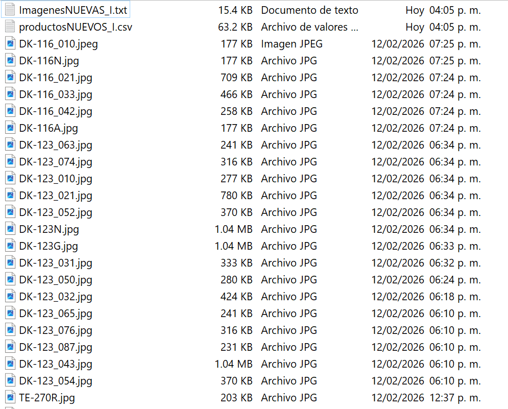

On any other folder, no problems... as you can see bellow...
On my CPANEL File Manager, I can see any file on that folder... so only happens on the DOpus ftp client an d on tha folder in particular.
