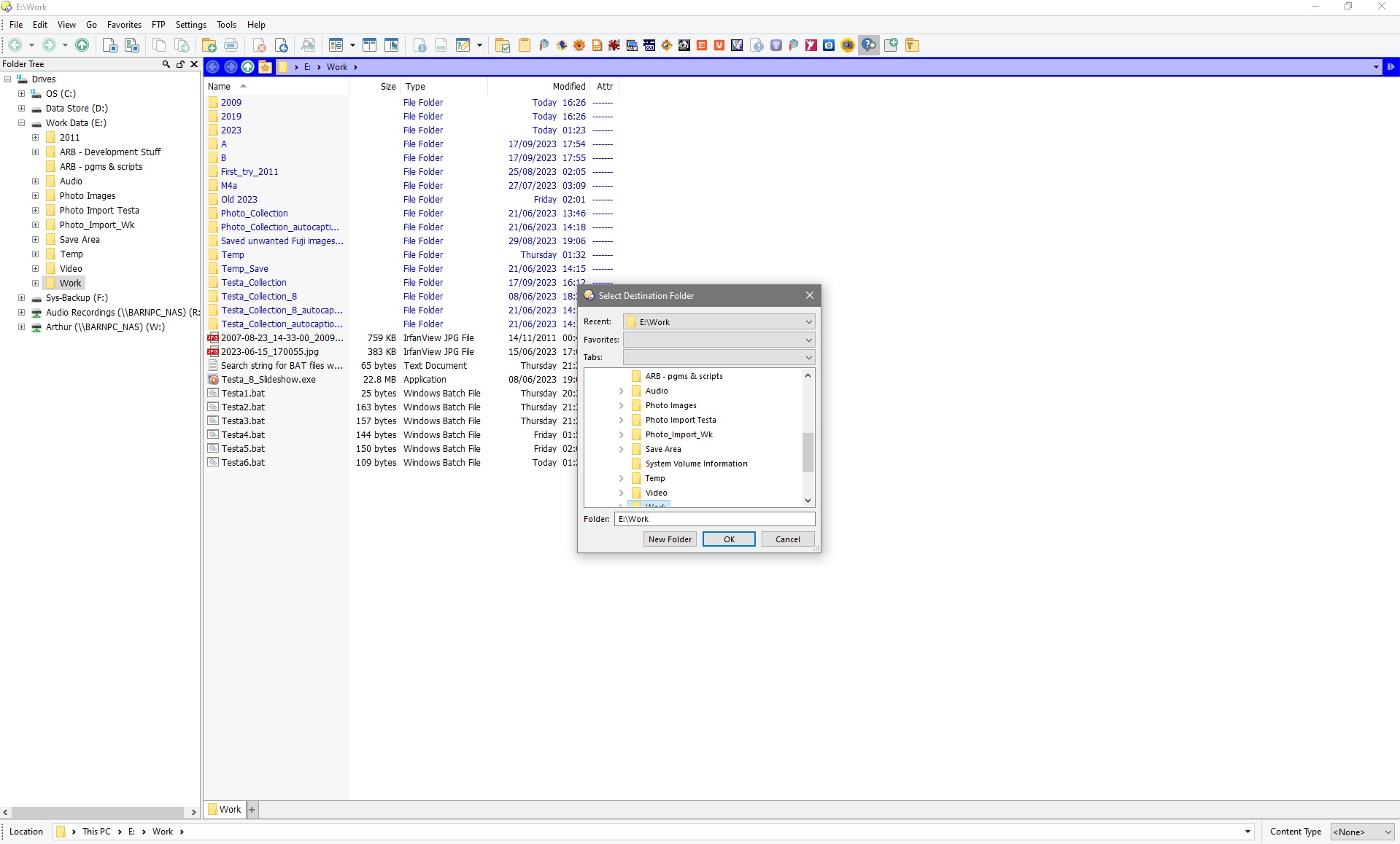

I am including a somewhat redundant screenshot of the dialog box
If you're using {sourcepath$} and {destpath$} in the commands, and there is no destination path (and/or no source path, which can happen with floating toolbars when no file display is open at all), then the button will prompt you for those paths.
{destpath$} means needs a destination path, so the button has to have one, by definition, and it'll ask if there isn't one.
You can use {destpath} (without the $) if the destination path is optional, but then nothing will be inserted there if there's no destination, which is rarely what you'd want.
What would you expect to happen otherwise? You've made a command that needs a destination path and then run it when there isn't one.
