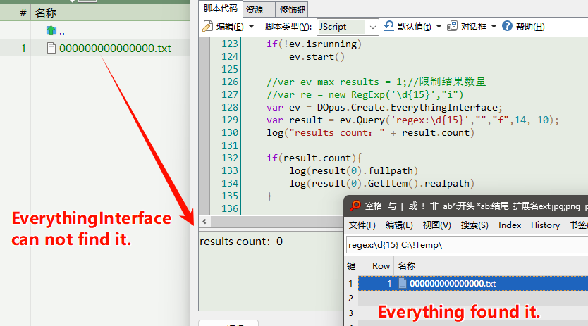

Can't EverythingInterface search for regex: properly like the Everything program window?
Test code:
function OnClick(clickData)
	var ev = DOpus.Create.EverythingInterface;
	var result = ev.Query('regex:\d{15}',"","f",14, 10);
	log("results count:" + result.count)
	if(result.count){
		log(result(0).fullpath)
		log(result(0).GetItem().realpath)
function log(str){DOpus.Output(str,false,true);}
there is a file: C:!Temp\000000000000000.txt
seacrh for: regex:\d{15}
In Everything program window , this file is found.
But using EverythingInterface, it is not found.
PS. I don't want to use ev.Query('\d{15}',"r","f",14, 10);
This can find the file: regex:0{15}
ev.Query('regex:0{15}',"","f",14, 10);

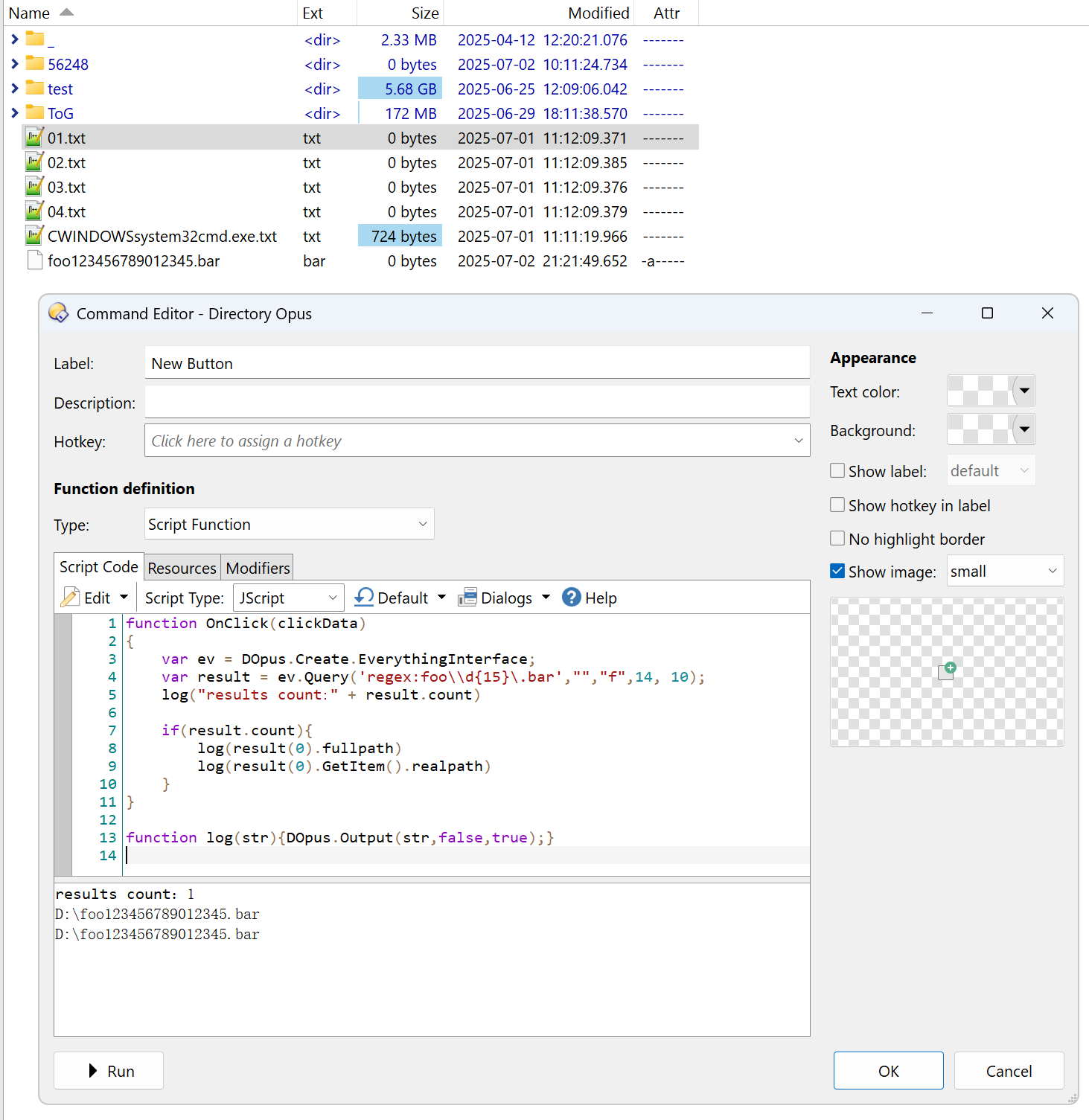

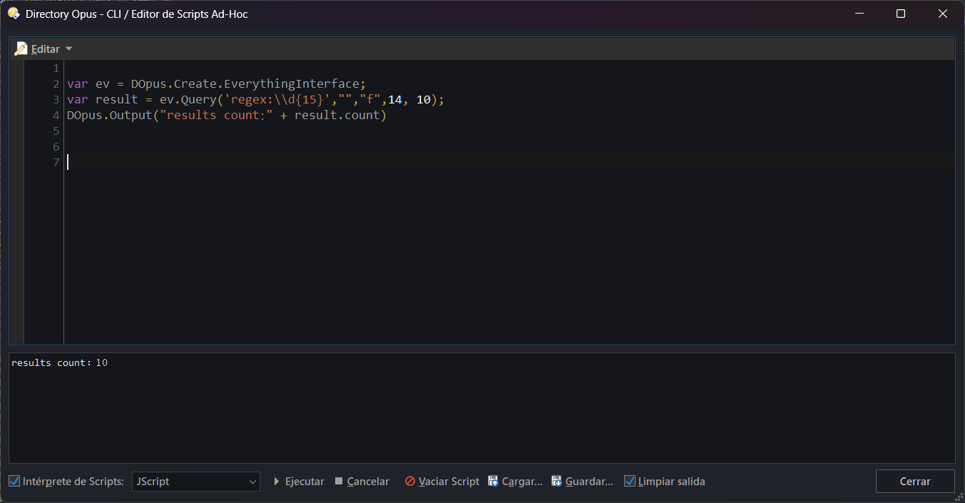

Have you tried regex:\\d ?
ev.Query('regex:\\d{15}',"","f",14, 10);
ev.Query('regex:\\\d{15}',"","f",14, 10);
ev.Query('regex:\\\\d{15}',"","f",14, 10);
All return 0 result.
So does ev.Query('\d{15}',"r","f",14, 10);

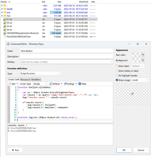

All I needed to do here was properly escape:

For example, in your case, if you don't escape \d, you'll see this in the log:
IPC: execute query: regex:d{15}
Use a ^ at the beginning like〈regex:^\\d{15}〉, will get the file 000000000000000.txt.
