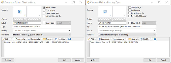

Here's the settings for both:

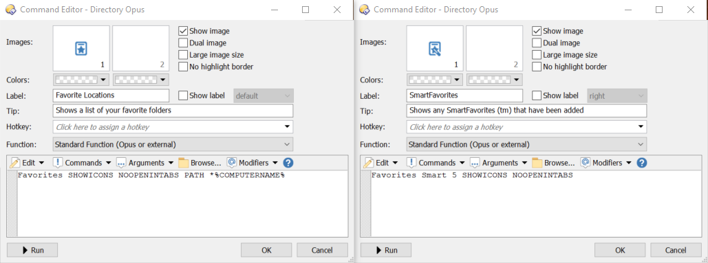

Even though it's not checked, check the "Show label" box and set the dropdown to the same setting for both. Then uncheck the box and see what happens.
D'oh - Yeah that fixed it, although specifically I turned on Show label and set it to 'right'. I could have sworn I'd tried that though!
Thanks!
