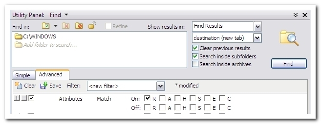

You can use Opus to find all of the R/O files in a structure. To do this, use the Find command (defualt Ctrl-F) in Advanced mode and specify a filter as shown below. Change the folder to reflect the structure you want to search.

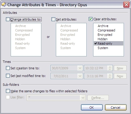

Once you have the R/O files displayed in a collection you can select the ones whose attributes you want to modify and then use the SetAttr command (default Ctrl-B) to switch off the relevant attribute, as shown.

Oops. I just checked with an unmodified default configuration and Ctrl-B is not associated with SetAttr by default. However, the default configuration does have a SetAttr button defined as shown below.
