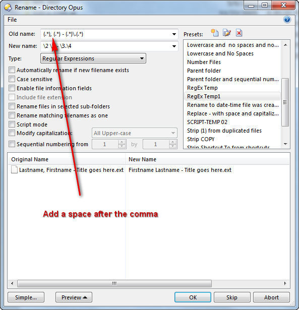

And Silly question #2: On the first rename dialog (to switch from Last, First - Title to First Last - Title), the RE adds a space before the Firstname in the renamed file. How do I edit the RE to eliminate this extra space?

Oops, you're right. However the fix is easy to make. Simply insert a space right after the comma in the following line:
Screen shot follows.
