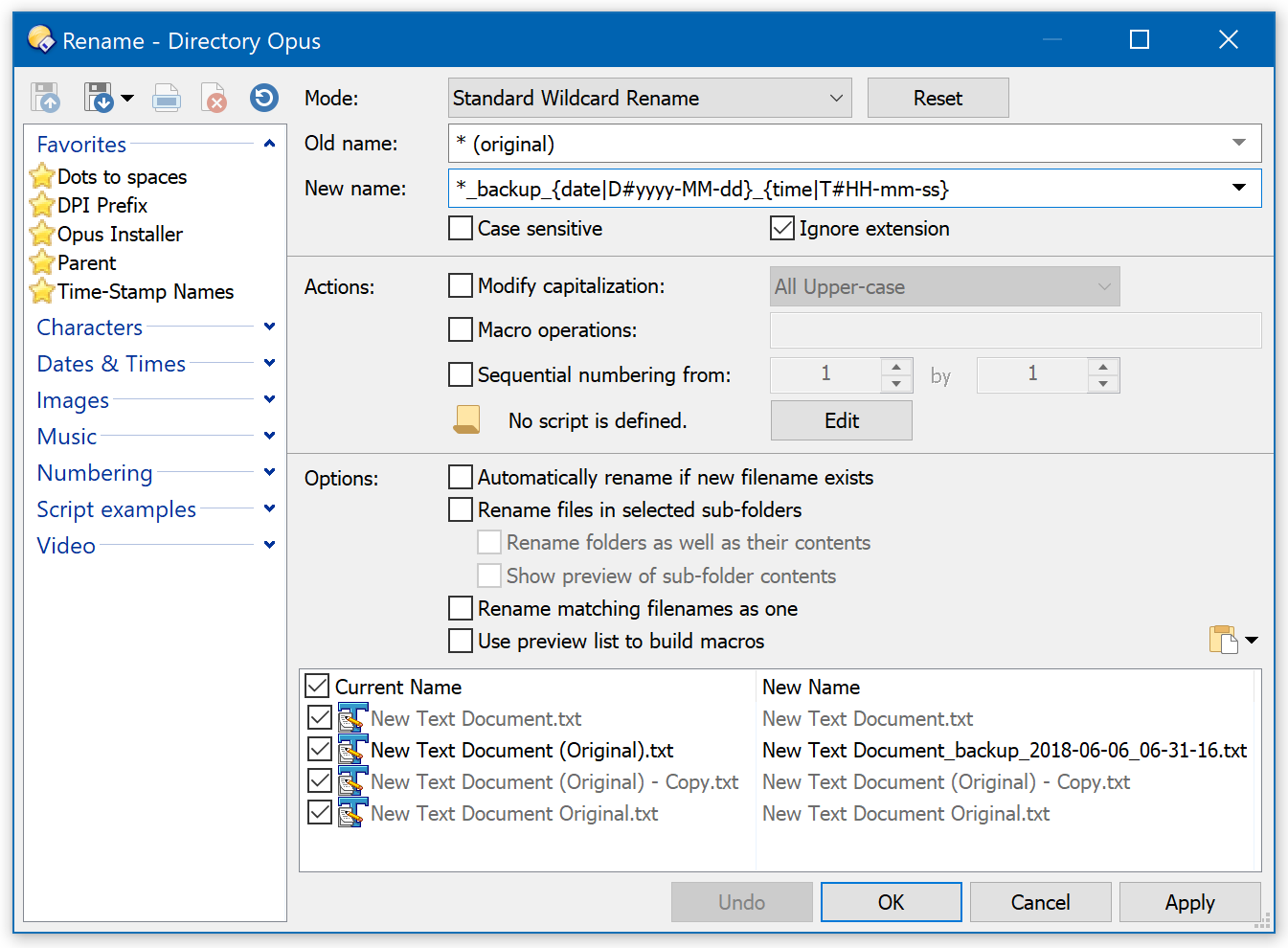

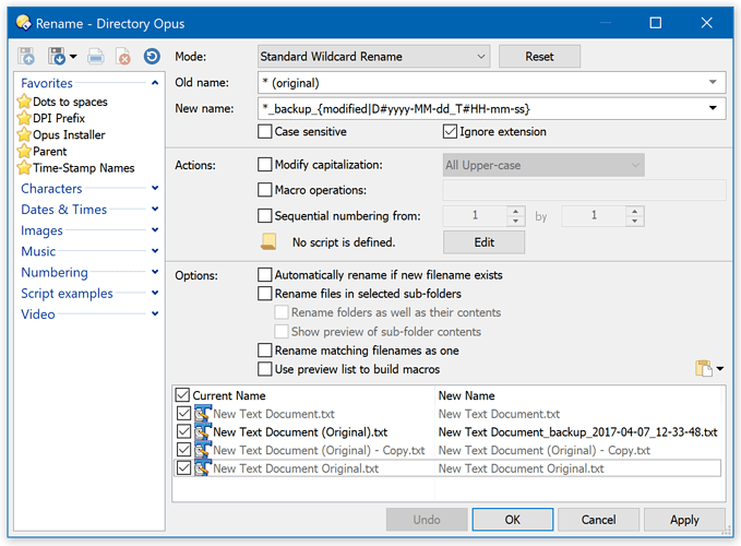

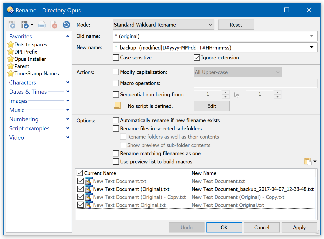

Standard Wildcard Rename
From * (original)
To *_backup_{modified|D#yyyy-MM-dd_T#HH-mm-ss}
(to use the old file's modified date/time)

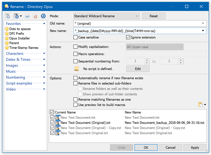

Or to *_backup_{date|D#yyyy-MM-dd}_{time|T#HH-mm-ss}
(to use the current date/time).
