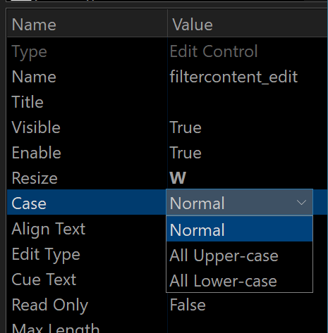

Do you mean in a script dialog? That's a property you can set in the dialog editor.
Yes - but I would like to change this programmitically through Jscript by clicking on an icon in the dialog
