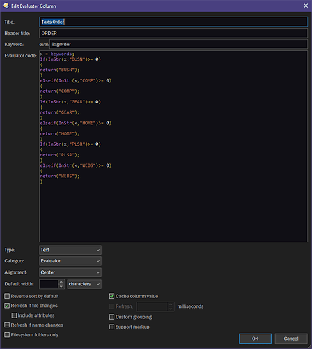

What's the definition of the Evaluator column?

This is an example of the buttons I'm using to add tags.
SetAttr META Tags:"-PLSR; +BUSN"
You can see, it should show up in my 'ORDER' column but doesn't. If I refresh it does.
Not Show Up

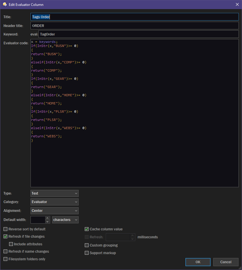

Here's the evaluator column:
