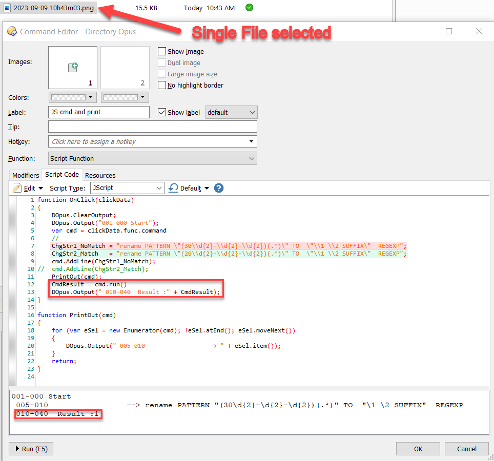

What can I expect from the .results property?
I need to execute internal commands from a script individually and then evaluate the outcome before proceeding.
I write up a test script first and shock horror it does not do what I wanted/expected.
It would seem that I cannot tell from CmdResult = command.run() if there was a match and consequent renaming of one or more selected files.
I run the script with 2 regex expressions one that I know matches and changes the filename and one that I know does not match and the filename does not change.
But I get the same result of digit 1 returned from cmd.run().

Understood. That is just the integer 1.
Presumably that just means the command executed without any error.
No other info available?

Question - Is there anything stopping me developing a script within the Rename dialog with OnGetNewName to do stuff other than rename?
My script does 2 sequential renames then moves the file(s) to another folder.
I am assumming OnGetNewName will give me better feedback on the out come of a rename action.
It will also give me a result on a per file basis which I had not considered when I started this post.
But what about moving a file as well?
I guess I can try and find out :slight_smile:
No. You can conquer the world from the insides of an rename script :+1:
Absolutely. Keep us posted about your progress. I'll get the popcorn in the meantime :sunglasses:
