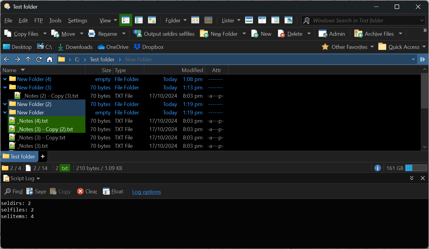

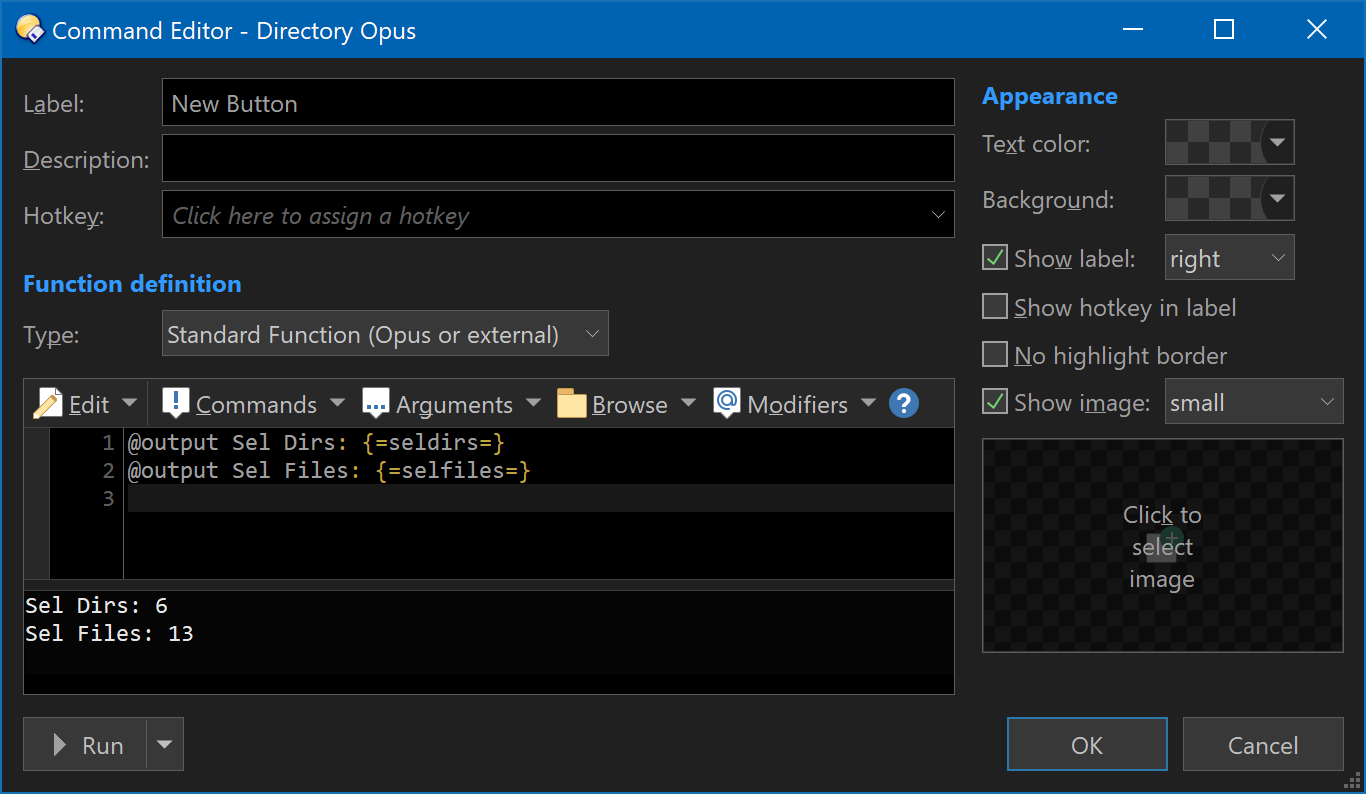

What makes you think they are always 1 or 0? A quick test shows that isn't the case:
Interesting! I always get 0 and 1 when calling that code from my CTRL+V script.

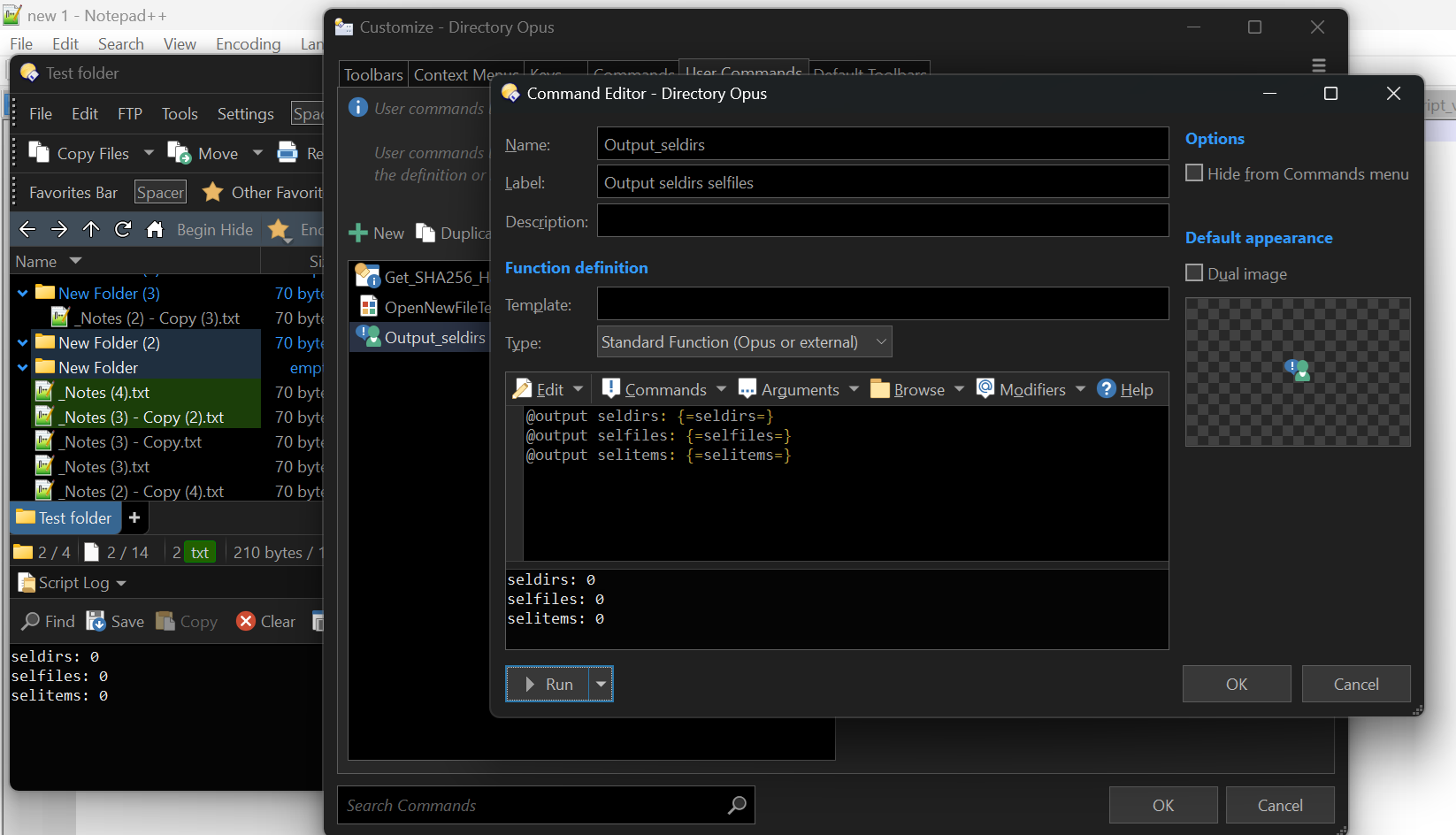

Side note, how were you able to get that output from Command Editor? Is there some setting I need to change, because when I try what you have in the screenshot I get all zeroes, even when I've selected files in the lister.
Screenshot:
But if I run with the command editor closed with no other code I get what you're getting:
[Update: I updated to the latest Beta and it appears that that fixes the side note that I wrote above — I can now see the correct output when clicking Run directly from the Command Editor. ]

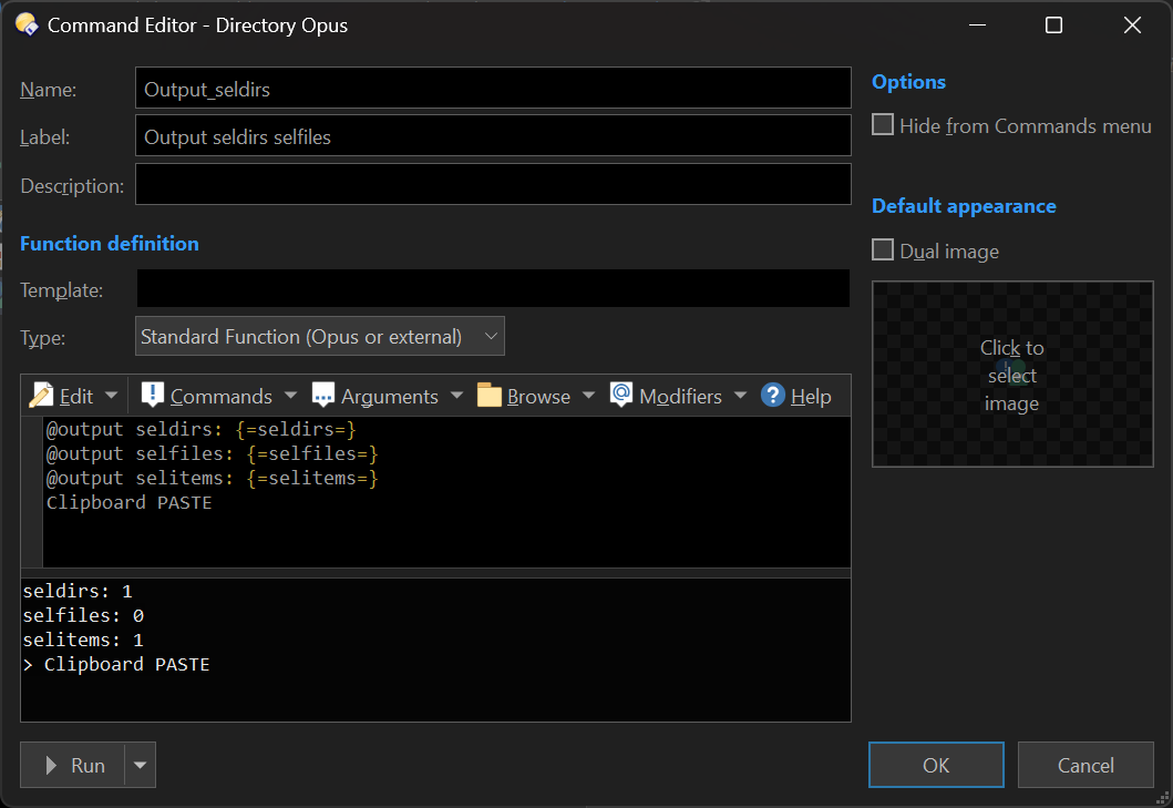

However, the seldirs and selfiles being always 1 or 0 still happens when there is a Clipboard PASTE command. It appears the existence of the Clipboard PASTE command modifies the context or something and changes seldirs and selfiles to 1 or 0 based on the top selected file or folder.
To be honest I'm not asking for that to be fixed if there's good reason for it, I was just not expecting it from the documentation.

Ah, yes, you are totally right. I didn't expect that either.
Looking into it, it's because the command itself (Clipboard PASTE) doesn't need to know the information the evaluator code is using, so the info isn't being (fully) calculated. (There's a bit more to it, about how different things process the arguments and selections, but that's the quick explanation.)
When there isn't a standalone command, or (probably the most common case) when the command uses the same information as the evaluator code, it's not a problem.
We saw a similar situation recently and have been thinking about ways to let the evaluator code specify what it needs.
