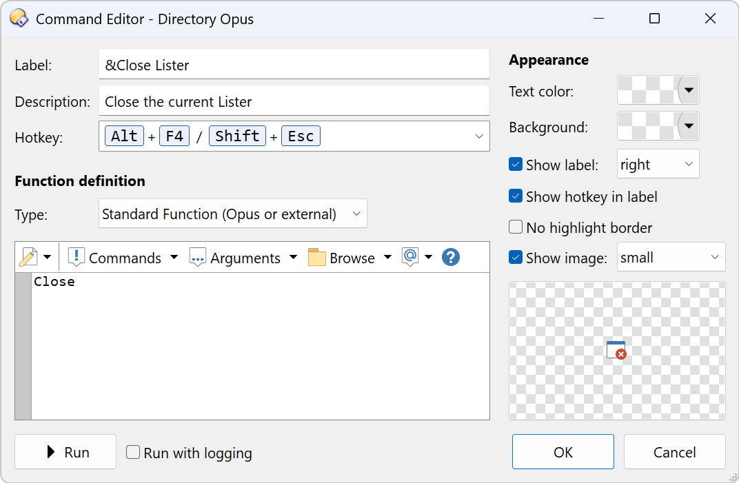

Shift-ESC is already there:
BTW: Wouldn't it be better to remove Alt-F4 from this button?
Windows will intercept it and close the lister itself.
I think it's there mainly to show the hotkey in the menu.
Yes... I once placed a script there and was quite irritated when that thing just refused to run properly :smiley:
