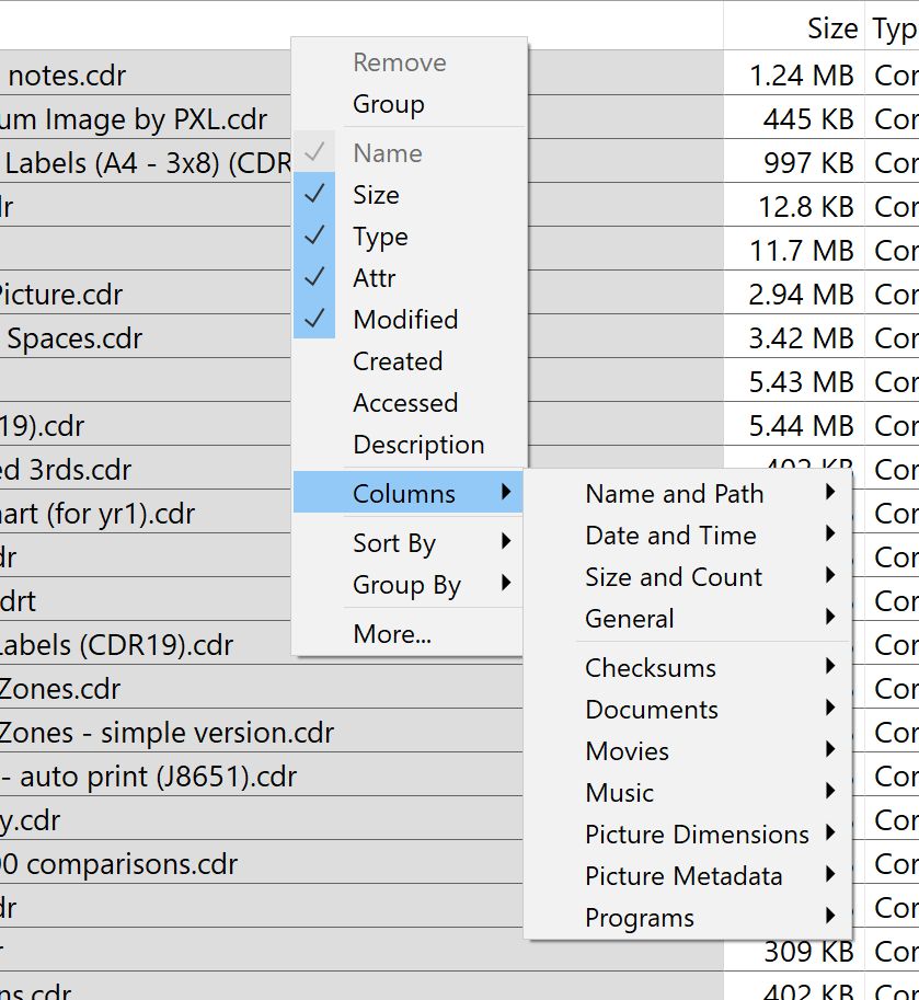

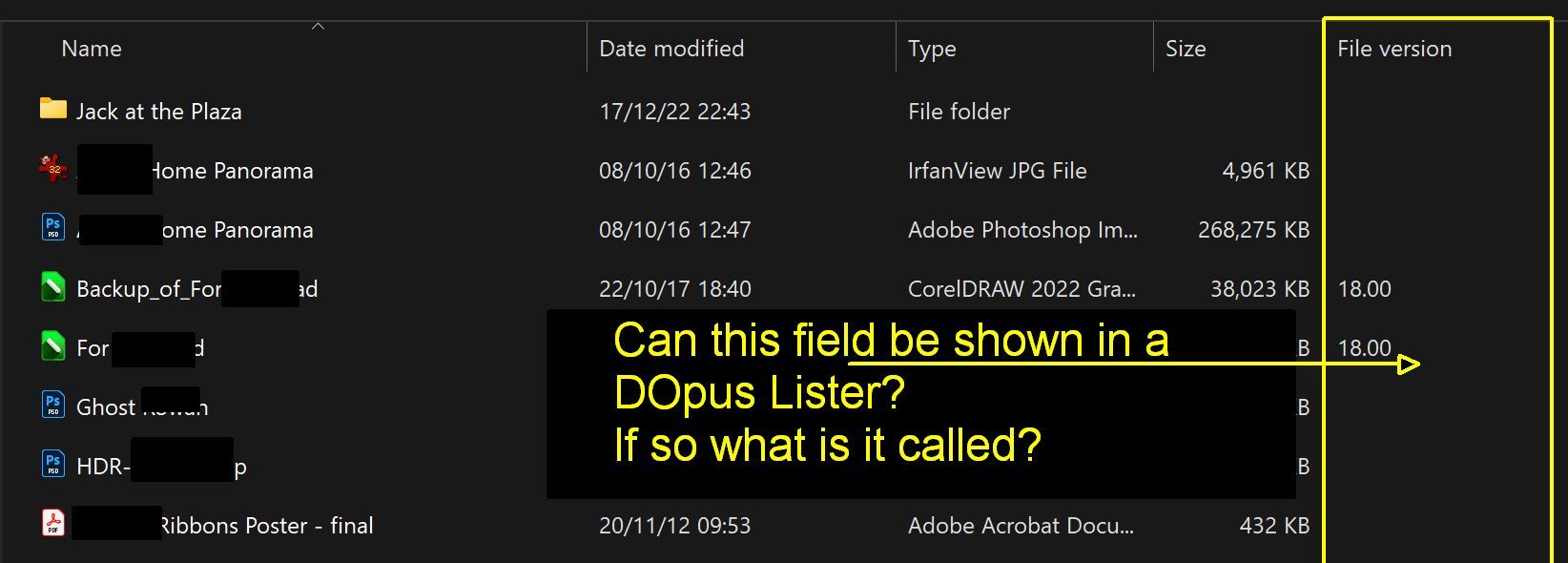

I would like to add a column to some of my DOpus listers to show the version of software which was used to create any given file. It seems that the closest I can get is the currently installed, default software for opening a file ("Type" column/field)

See attached image.
Dopus 13 Beta lets you import columns from Windows-Explorer.
https://docs.dopus.com/doku.php?id=:preferences:preferences_categories:file_display_columns:shell_properties

If the column already exists in File Explorer, and you don't mind using the Opus 13 public beta, then Hardkorn's suggestion is the easiest.
  • Go to Preferences / File Display Columns / Shell Properties (shown in Hardkorn's screenshot).
  • Drag one of the CorelDraw files to the Example file field at the bottom.
  • Turn on Group properties with data to make things easier.
You should see the "18.00" value on one of the lines. Just turn on that line and click OK, and that column will then be available in Opus, under the Shell category.

Leo's solution worked and it has carried over to the full Opus 13.1 which I have just purchased as an upgrade - but -
I cannot work out how to get the "File Version" column in view when using "Find Files."
"Shell" does not appear in the sub-menu...
Using an ordinary Lister...
Using "Find Files..."
