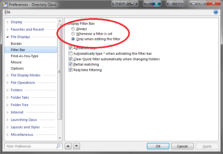

Yeah, that's why. "Set QUICKFILTER" on its own will show the filter bar, so @ifset:QUICKFILTER is really testing whether the bar is visible or not, not whether a filter is defined. With the middle options, those two states are the same, unless the filter is actively being edited.
Ok I understand. All in our team are used to work with the FAYT filter-bar instead of the more complex quickfilter bar. Thus unfortunately enabling the more complex quickfilter is not an option.

What's complex about the filter bar? It's just a nicer UI to replace that aspect of the FAYT field, with some indicators that help you see how many items are filtered in/out.
Maybe it can be improved by configuration but the feedback in our team was that most people don't like the filterbar because it doesn't show the results incrementally. On the other hand the FAYT field does so, thus we switched over to FAYT.
Example:
Assuming you have the following files:
text-1.txt
text-2.txt
document-1.doc
document-2.doc
Now you start typing: *.doc
If you reach *.d when using the filterbar leads to an empty lister but when using the FAYT you can see how the result set is reduced in realtime. The latter is much more intuitive. Certainly you can type .d but this isn't really applicable.
Preferences / File Displays / Filter Bar / Partial matching
Preferences / File Displays / Filter Bar / Real-time filtering
I already tried these settings but then you have to omit the wildcard (e.g. simply typing doc) what would lead to false positives since the pattern is applied to the name as well. If you want to suppress these false positives you have to explicitely enter the wildcard and this in turn leads to the same empty result list during typing.
Woa, I can disable "Automatically type * when activating the filter bar" which provides exactly the same behaviour as in the FAYT field. Haven't seen that option so far. Thanks for committing to this considerations. :thumbsup:
