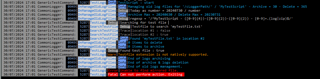

Here's a preview at what Console logging can look like :

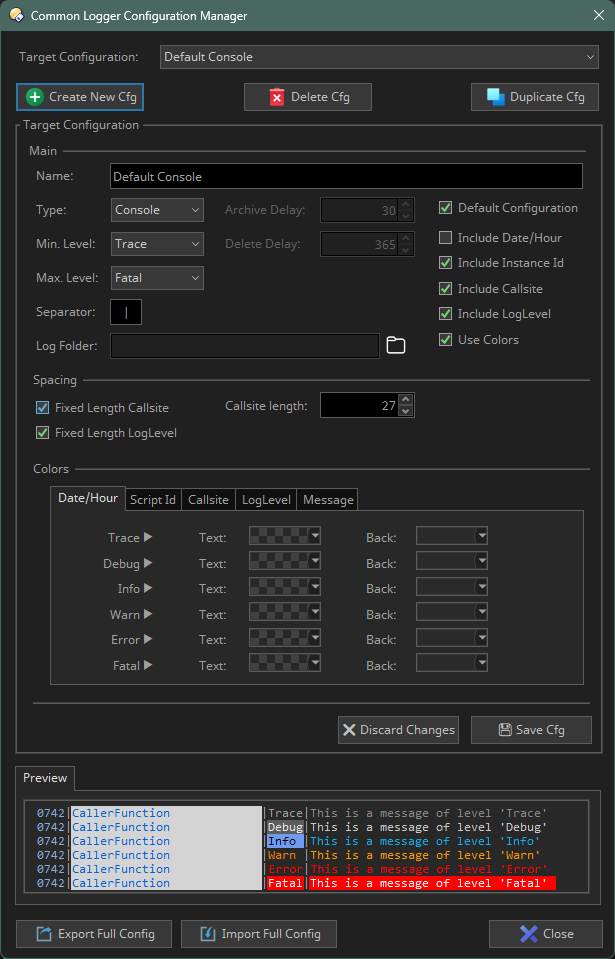

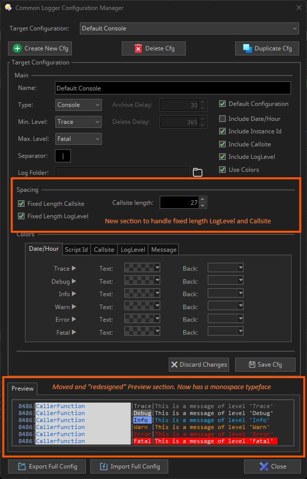

Here is also a screenshot of the template configuration manager :

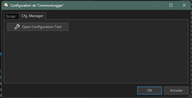

And the specific tab that can be accessed from Settings/Script/Cog Wheel has changed its name (to "Advanced Config") and provides a way to set the Global Minimum LogLevel:

This is a per target setting, so it is configured in the Configuration Manager (see screenshot above).
Fixed Length LogLevel: when activated, every LogLevel field is taking as much space as any other (e.g. as the longest loglevel).
In order to manage alignment, you can also define a fixed length for the Callsite (or caller function) field. Every shorter callsite will be right padded with spaces, every longer callsite will be truncated.
The result can be seen in the Configuration Manager screenshot.

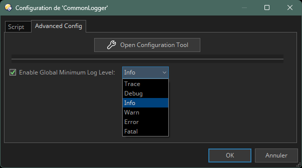

Global MinLevel
The global min loglevel can either be set from the script config Advanced Config tab and lets you define a new min loglevel that applies to all loggers whatever the script.
It can also be set from the code:
LoggerNS.ForceGlobalConsoleMinLogLevel(LoggerNS.LogLevel.Info);
// (...) some other actions and logs
LoggerNS.DisableForcedGlobalConsoleMinLogLevel();

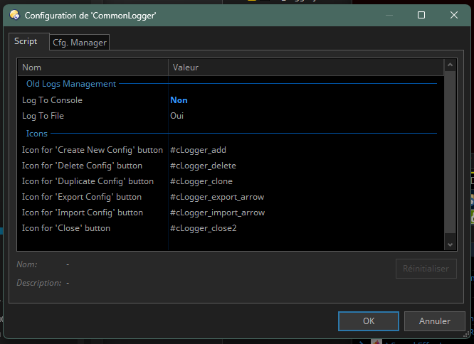

  • Settings are split in two groups: Icons which holds the previous parameters, and Old Logs Management which holds two new parameters:
  • Introduces 2 new parameters: Log To Console & Log To File: Let you decide how/if you want the common logger command ManageOldLogFiles to log its actions. This command is called whenever a script logs its first entry within a script execution and manages previously created log files to check whether their execution date was prior to archiving delay or deleting delay.

New release : V0.9
CommonLogger.opusscriptinstall (26.0 KB)
CommonLogger:
  • Since ManageOldLogFiles can now log to file, this command is now protected against some kind of recursivity (one script logs, which triggers this command for this script, which logs, which triggers this command for OldLogsManager, which logs, which triggers this command for OldLogsManager, ...).
    • Note: This is achieved by using a Map Script Variable which stores the calling script when triggered and removes it just before exiting. If any other call occurs while it is being processing the old archives, it will not be processed.
  • The CommonLogger UI (used to create the target types, their color scheme, ...) can now be called from the standard Script configuration window in a new tab (in addition to the previous way, through ConfigLogger command):
  • Opus min version raised to 13.19 in order to support usage of these two Opus features (Settings Groups & custom tabs in script configs settings).

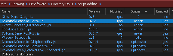

Definitely an improvement. To be honest: for the moment I couldn’t care less about “old logs” (but that’s just because I have too little patience with things I don’t understand or need) - so I now disabled both those logs and I’m perfectly happy with such a tool that adds so much to Opus by just adding an include and a few changes.
This is maybe the first script that feels (for me at least) entirely like its part and parcel of Directory Opus - especially with the Config Manager dialog. Well, that’s not entirely true, some scripts by @errante have that feel too, I must admit (his MediaInfo++ for instance). And I got such a feeling also when I messed around with @tbone ‘s ScriptWizzard - even if it was old and obsolete.
There should perhaps be a page that lists all scripts that are truly enriching Opus as “setup tools” (maybe with a dedicated badge of honour as well). Any hints, anyone, for more scripts in that sort of category?
What, obsolete? o) I still use it to upload and keep track of changes in scripts (ScriptWizard adds a MD5 checksum to every script you upload, so you know what scripts or changes were not released yet). It also offers some script columns to show script information directly in the folder, which makes handling / copying scripts more easy at times, because the preferences page for the script does not have all these information and you also can't move / copy from there. So, it still has plenty of usefulness I think! o)
It would not hurt to maintain it again though, I agree on that part. The auto / update mechanism for scripts failed at some point, never got around to fix it. Then this forum changed the listing / categorization of scripts and the german forum went down completely, taking all the script uploads and reference-urls with it. The general appreciation was also rather low and so you end up with what seems like abandon-ware. o)

In order to use/set these features, besides code additions, the Configuration Manager has evolved:

Spacing/Alignment
Global and Local min log levels
:warning: This settings only apply to Console type targets. The File type targets remain unaffected by these settings. :warning:
Global MinLevel
Local MinLevel
The local min loglevel can only be accessed from the code and acts directly on the logger object:
logger.EnableForcedLocalConsoleMinLevel(LoggerNS.LogLevel.Trace);
logger.DisableForcedLocalConsoleMinLevel();    // Not mandatory. Since it is tied to logger object, this is reset at every script launch.
What level prevails over the others?
  • When Local LogLevel is set: a console log occurs only when its level is above the Local LogLevel
  • Without Local LogLevel, but with a Global LogLevel: a console log occurs when level is both above the global log level and the target log level
  • Without Global nor Local log levels activated: this is the standard way, the log occurs when level is above the target min log level
