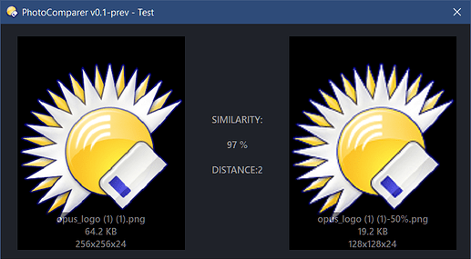

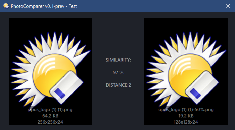

To keep this short, here’s a test version of a script that compares two images and shows their similarity percentage. The closer the value is to 0, the more alike the images are.
To use it, first install the script.
PhotoComparer.opusscriptinstall (5.2 KB)
Then, just select a couple of images (at least two) and run PhotoComparer.
You can also drag and drop images onto the dialog—whichever side you drop it on will be used to compare against the image on the opposite side.

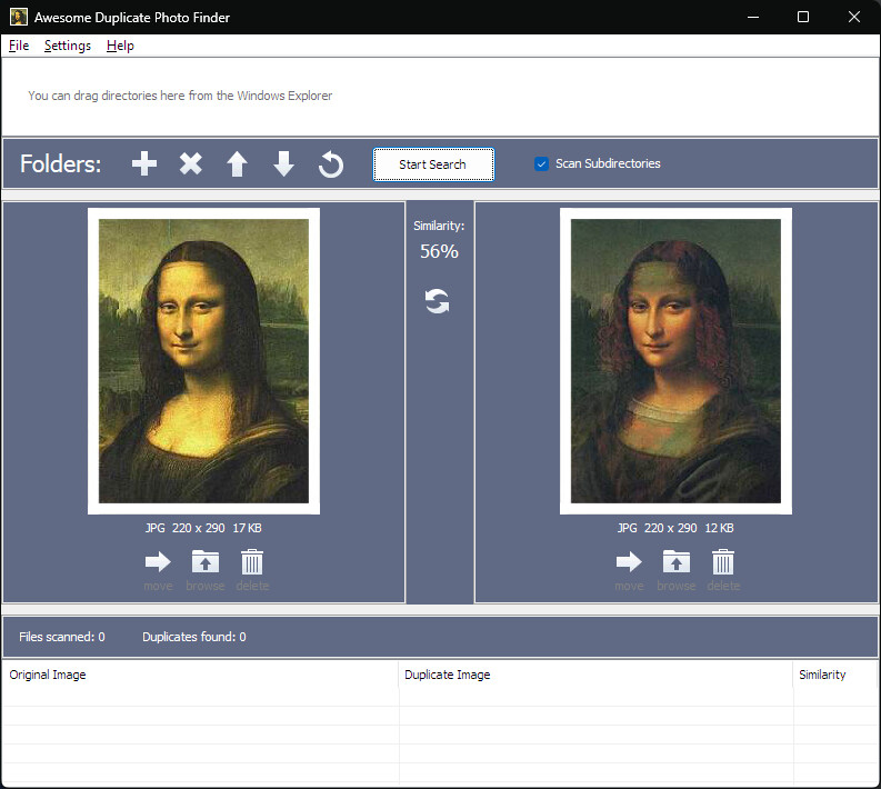

I use this
Awesome Duplicate Photo Finder - Find and Remove Duplicate or Similar Images
Awesome Duplicate Photo finder does not look at EXIF date metadata.
There are only 2 de-duping applications that can be used to compare photos' EXIF DateTimeOriginal: Duplicate Cleaner Pro 5 (by DigitalVolcano) and dupeGuru.

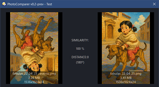

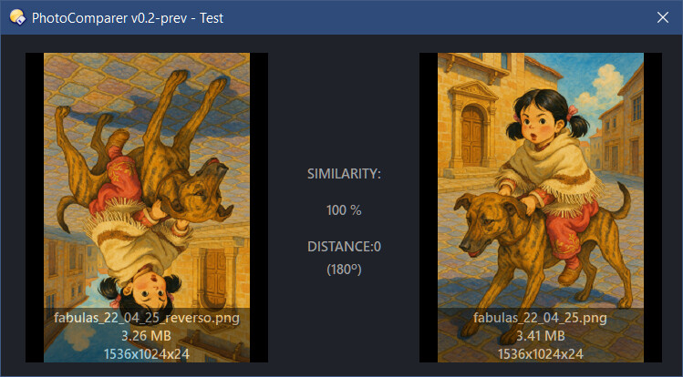

A heads‑up on this: I think I’ve figured out how to add support for rotated/flipped images—and the best part is it doesn’t need any extra image manipulation!

and it is awesome, many thanks - is there a problem with small images ? I do a lot of icon images, but it comes with warning/error that image is too small.
Yes, because the first thing the algorithm does is shrink the image down to 32x32. Any image smaller than that would need to be upscaled, which could potentially affect the rest of the processing. That would increase the chance of false positives—basically making it think most small images are similar in some degree.
I didn’t mention this earlier, but transparency in images also plays a role in increasing inaccurate results.
FWIW, last night I played around with the other algorithms, and I remember that dhash can handle images as long as they’re bigger than 9x8. So I could probably add some auto‑detection to switch the algorithm based on image size.
