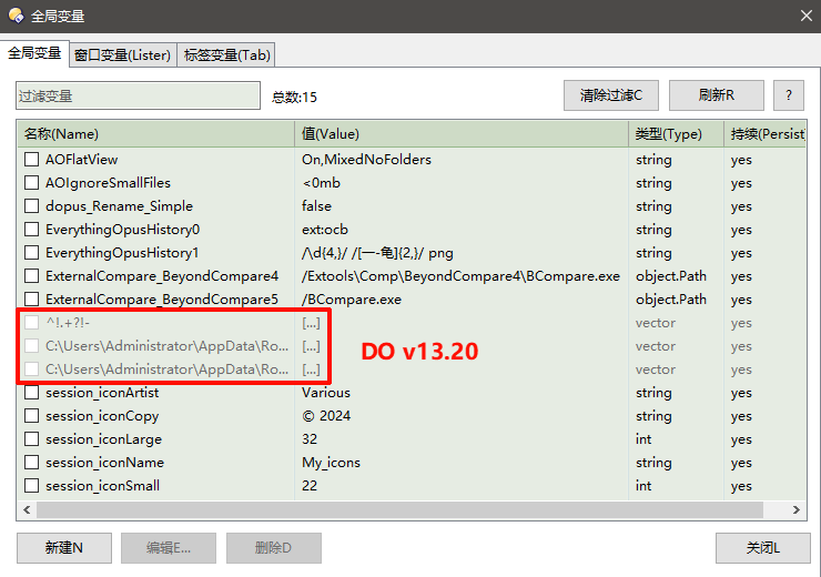

Control.AddItem() add a Vector, the added DialogListItem'name is not variable name of the Vector
This bug is reported here: Global Variables Tool - #24 by aZtraL
An example Global Variables:
name: Script.SelectEx.StoredSelection.1_Slot      type: object.Vector
in DOpus v13.19,
        var i= listVarCtrl.AddItem(strName);
        var dlgListItem = listVarCtrl.GetItemAt(i);
then, dlgListItem.name is Script.SelectEx.StoredSelection.1_Slot
so we can use listVarCtrl.GetItemByName(strName)
but in DOpus v13.20,
then, dlgListItem.name is not Script.SelectEx.StoredSelection.1_Slot,
dlgListItem.name is the fiist item in the object.Vector (as I guess).
so we can not use listVarCtrl.GetItemByName(strName)

That is because when you enumerate your object.Vars,eVars.item() is an object of type object.Var.
Since a certain Opus version, Control.AddItem() accepts vectors as parameters to fill multiple columns at once.
When you use Control.AddItem(eVars.item()), and eVars.item() translates to a Vector, Opus interprets it as if you are passing a Vector (here you could argue whether this should behave like that or not). But the correct thing here is to ALWAYS send a string. In this case, eVars.item().name.
On a side note, as advice, since your data is only for display, the most practical thing would be to create an object (eg. a Vector) with all the values you are going to show in the ListView just once, instead of generating it every time you filter the list. This way you avoid these issues and your dialog becomes faster when filtering/filling data.
