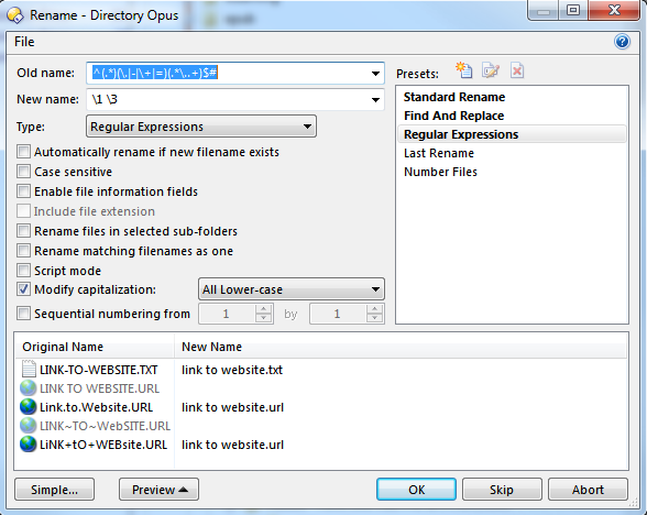

Hi Leo, I followed your example and couldn't get it to work. I can convert the text to 'all lower case' using the standard rename option but that's about it.
If I select 'Regular Expressions' only the first file in the list is highlighted, all the other files are greyed out. When I click OK only the first file is converted to lower text, the rest remain unchanged.
I've had a look through preferences and can't see anything obvious that would preventing me getting the same result, how odd :exclamation:
Difficult to guess. Maybe showing us a screenshot of your rename dialog will make it obvious what was missed.
I have just realised why they are greyed out, some of the text has different symbols and spaces and they just need adding to the script you posted.
How do I add the [space] [#] [~] symbols to the script?

There's no script here, just regular expressions. The manual covers the basics and there are more examples in the Rename Presets area. There are also lots of tutorials on the web about regular expressions, although watch out because almost everything uses a slightly different version of them, just to confuse things. :slight_smile:
Let's look at the old name string:
This part in the middle is the important bit:
That says: find a . - + or =
The . and + have a \ before them, because they have special meanings normally and you need the \. to say "I want an actual . character" and \+ to say "I want an actual + character".
So if you want to add space, # and ~ then you might end up with this:
Putting it back with the other bits:
Note: I haven't tested this, so apologies if I got something slightly wrong. It's possible the # or ~ need a \ before them like the . and + did, but not as far as I am aware.

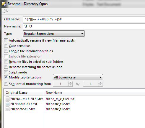

How would the full string appear? Out of curiosity I thought I would try your version but couldn't get it to work, the text is just greyed out.
Any ideas?
Old name: ^(.*)[-~.+=#\s](.*\..+)$#
New name: \1_\2
Note: you can't have a space or \s character inside the character class and use it to break apart the words in New name. If you want to use a space to separate words in New name, remove the \s in the character class:
Old name: ^(.*)[-~.+=#](.*\..+)$#
