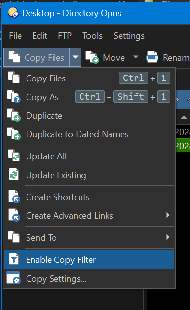

First, turn on the copy filter here:

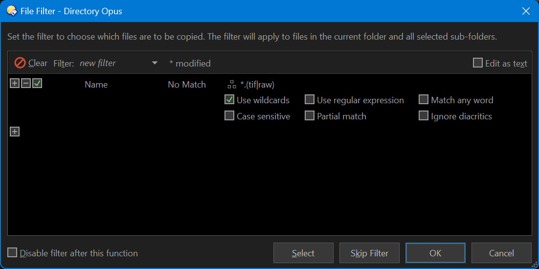

With that on, when you copy files normally, you'll be asked how you want to filter them. When prompted, you can define the filter like this:
Note that the filter usually only applies to things below selected subdirectories. If you have some .tif or .raw files selected at the top level, you might want to deselect them first. (Or go up a level and copy the directory you were just in, with the filter in place.)

As I mentioned to lxp, I am a long-time dopus user. But I have never paid attention to the "Copy Files" menu item. Where is there documentation on the capabilities of this feature? I think it might be time I paid attention! :slight_smile:
