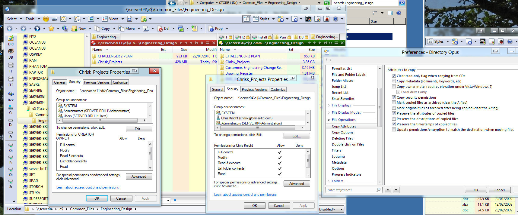

Okay just tried this out at work.
I opened the source (\SERVER04\e$) and destination (\SERVER-BRI11\d$) drives on the two servers directly within DO after turning on the option (as can be seen right hand side).
The source server SERVER04 shows that the 'Chrisk_Projects' folder should be read / writeable by Chris Knight only, for example Authenticated Users are denied access.
The folder when copied onto the destination SERVER-BRI11 has authenticated users having full access and there are no special security rights for Chris Knight.
So I'm either doing something wrong or I've found a bug?

Okay the copy of the 'Chrisk_Projects' folder has just completed but the permissions are not set correctly, they are as I originally reported.
Now that the copy has completed there are some weird permissions:
\server-bri11\d$\Common_Files\Engineering_Design\Chrisk_Projects\ARCHIVE\ - No security set for Chris
\server-bri11\d$\Common_Files\Engineering_Design\Chrisk_Projects\ARCHIVE\Laser CRT\LaserCRT 005.jpg - Permissions correct
\server-bri11\d$\Common_Files\Engineering_Design\Chrisk_Projects\ARCHIVE\Laser CRT\Laser CRT_files\ - No security set for Chris
\server-bri11\d$\Common_Files\Engineering_Design\Chrisk_Projects\ARCHIVE\Laser CRT\Laser CRT_files\themedata.thmx - Permissions correct
In fact all the checks I've done show the security is correct on files but not for folders.
It looks like permissions not set on folders which are below a folder which is being "merged."
So, with the Chrisk_Projects folder selected in the source, if that folder already exists in the destination, then the permissions will not be set on any folders below it (even ones which are created during the copy). Permissions will only be set on the files.
If the Chrisk_Projects folder does not already exist in the destination, then all the permissions on both files and folders should be copied over.
Does that explain what you're seeing?
I'm not sure if what we're doing is completely right, but that seems to be the current behaviour. (I think it makes sense not to change permissions on dirs which already exist, but if we create a dir, and are set to copy permissions, then it seems right to set the permissions on that dir. Or, "more predictable" is probably a better phrase than "right," since I can see situations where both ways might make sense, and there isn't really a canonical way to deal with permissions when partially-merging two folders.)
Okay I had resumed the copy with the folder left in place. I've now deleted it and restarted the copy so now that the destination folder does not exist we'll see what transpires.
Okay with the original folder killed off it looks like the copy worked as all permissions now look to be okay :slight_smile:
