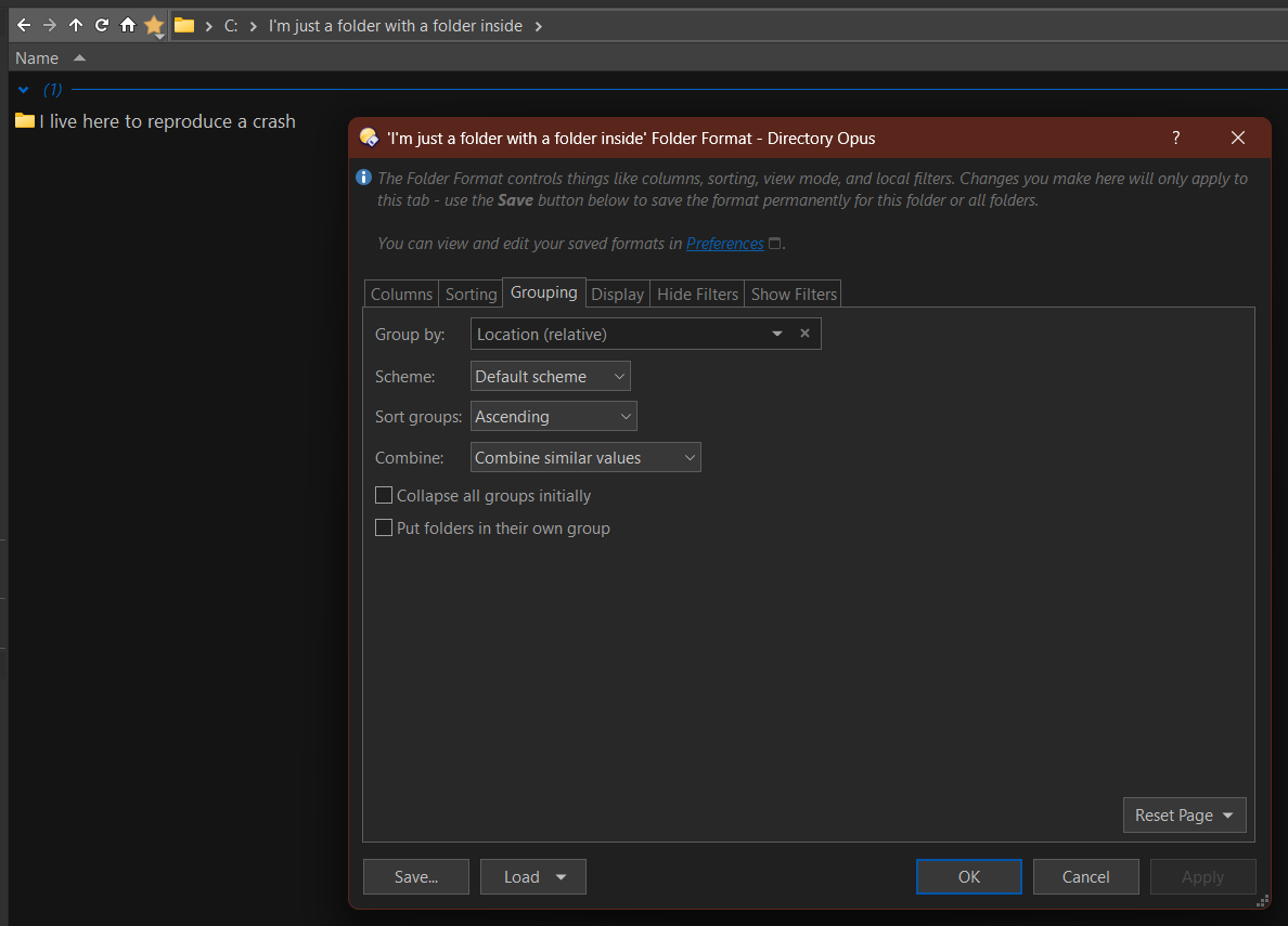

Steps to reproduce:
  1. Open a folder that has at least one folder inside it.
  2. Open Folder Format > Grouping
  3. Group by: Name and Path > Location (Relative)
  4. Put folders in their own group: OFF
  5. Press OK
[You can of course group it outside this dialog of course, this is just the easiest way to also check that the Put folders in their own group options is off at the same time.]
Folder(s) should now be grouped in groups of 1 each probably.
[Quite useless groupings, I know, but still just for this crash purpose.]

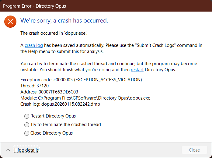

  2. Crash boom bang :sweat_smile::v:

Two crash logs submitted, ID 682.
To help with reproducing, this is the lister view state you want to achieve:
And if you collapse that group, and then trigger a Go REFRESH it will crash.
Happens on both my systems without fail, one running 13.20.4 (Beta) and one running a fresh install of 13.20.
