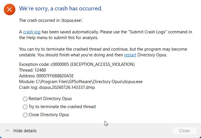

Just got an error message that Dopus crashed due to what I believe it said was a 'context' error from a program called Tune Explorer. It's a small program for looking at music file meta data and I was not even using it at the time, but I was using Dopus to look at a folder of Mp3 files. I'm submitting the error log and will reference this post as per the submit info.

I will watch it, try to be more propared and let you know of anything new. Whole thing caught me totally by surprise. Probably no help, but I think I may have mis-titled this, I'm not sure it said 'context menu' probably should be 'context error' instead. The error came up and then Dopus was frozen solid and I had to restart.

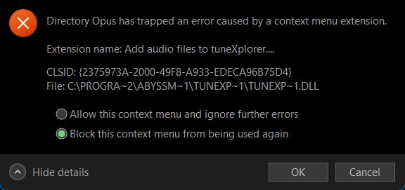

It happened again when I left clicked on a .flac file. Here are the screen captures from the error messages and I'll also submit the error log.

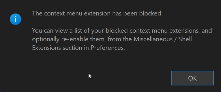

Earlier today I had just re-enabled the context menu in Preferences, so it had been disabled since the first error as I just went with the defaults of disable on the previous error.
Crash log submission ID 782.

It's inconclusive, but looks like the Tune Explorer context menu may have a bug with how it handles reference counting (AddRef, Release and QueryInterface).
It may be worth reporting to the Tune Explorer authors, but failing that I would leave it blocked to avoid the crash. I can't see anything that we can do on our side to prevent it.
You're welcome, glad it helped and thanks for checking on it.
I reported this to the TuneExplorer folks in case they want to try and fix it for future versions. I will be leaving it blocked in DO for sure. It's just a free feature limited trial that only does a couple of things so I'll probably just uninstall it anyway.
