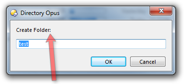

Ok, I get the pipe, I get the dlgstringS. but I don't get the colon. It doesn't seem to do anything?
The colon makes a colon appear here:
Ignore that quesion. doh
