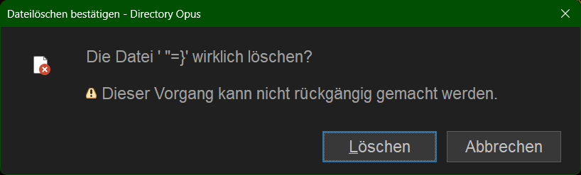

Thanks, that was it. But something was wrong anyway. I had following code for my Delete command:
Delete {=PathType(source)=="coll" ? "REMOVECOLLECTION" : ""=}
Which looks very strange to me. I can't recall that i have put it there. I have tried to delete some files, and got following error messages. And like i said, i can't explain that strange code above. Does it male sense anyway?

Ok, i found the reason. It seems, that the alternate code from this post doesn't work anymore, since the latest beta.
(Delete {=PathType(source)=="coll" ? "REMOVECOLLECTION" : ""=}
Yes, sorry. Anyway, i have to use Delete Removecollection=auto now.
That's a better command anyway.
We'll look into why the Evaluator version stopped working in case it affects other things.
Thanks!
Evaluator version of the command should work again in 13.14.9 which we just released. (But I would keep using the =auto
command instead, as that's what it's for.)
Yep, i will do that. Like it was before.
