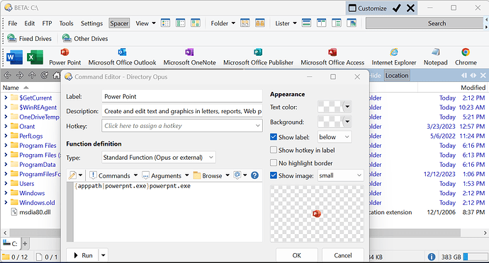

Currently, I have to manually remove the labels and set the icon to "large" on each of the items on the Office 365 toolbar. Would it be possible to add an option to remove labels for all items and set all icons to large on a specific toolbar?

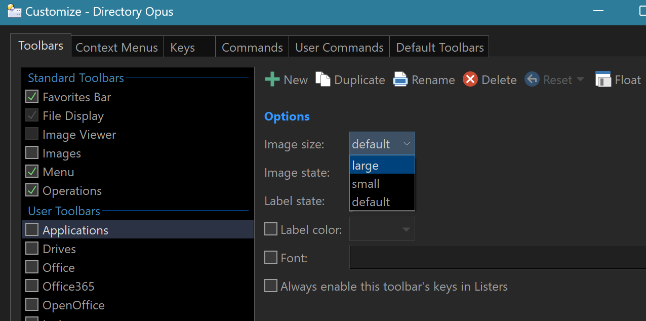

You can override the image size for a whole toolbar from the Customize dialog:
Do I also have the option of removing the labels for the whole toolbar as well?
Yes. Same screen, "Label state"
