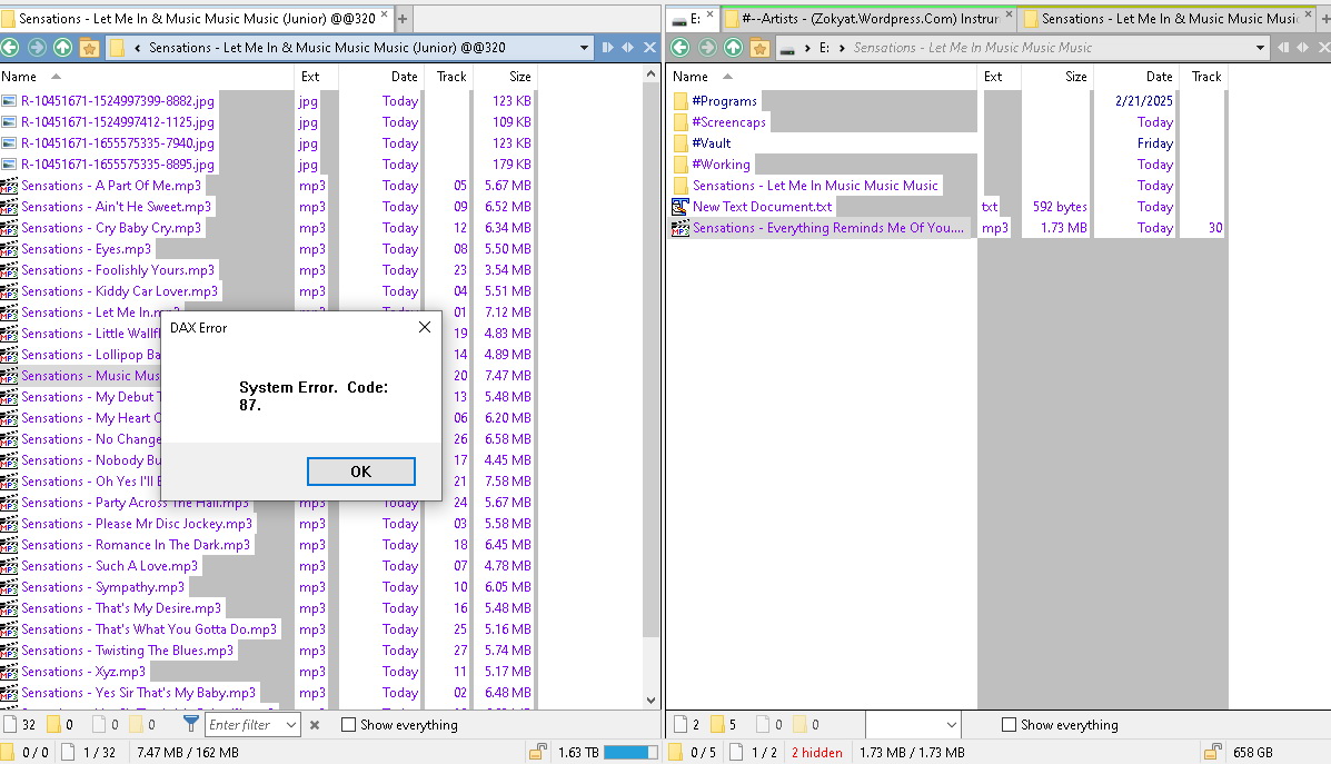

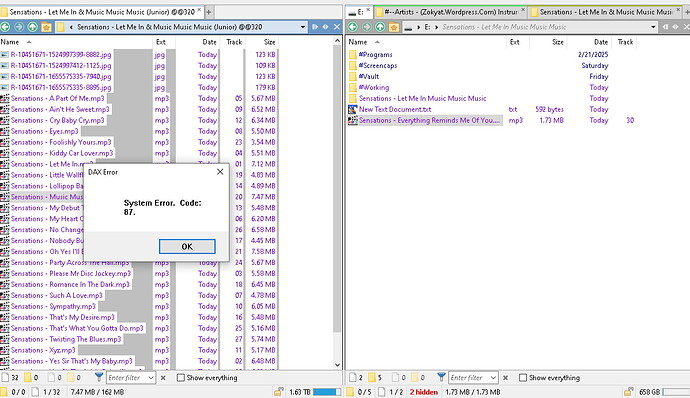

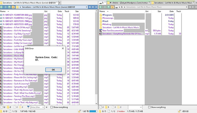

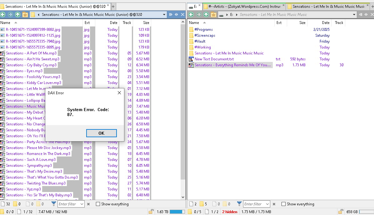

12.33 DOpus. Lately many times I get a dax error with the screen animating like it is moving columns files etc. Cannot close must use taskbar to get out. Very strange. How do I fix this ? Windows 10

Checked audio drivers all up-to-date not playing music just sorting with Dopus and renaming. Seems to happen when right click on a single file to rename. Only happens in Dops no other programs ever ?
