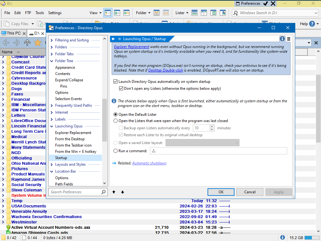

What options are set in Preferences / Launching Opus / Startup ?
I deleted all listers except default. I looked in startup and “Default” was the lister. So note that there is only one lister now “default” not “Default”, so I renamed it and it now works. So if there was no lister named “Default” (capital D”) what was it doing and where could it be?

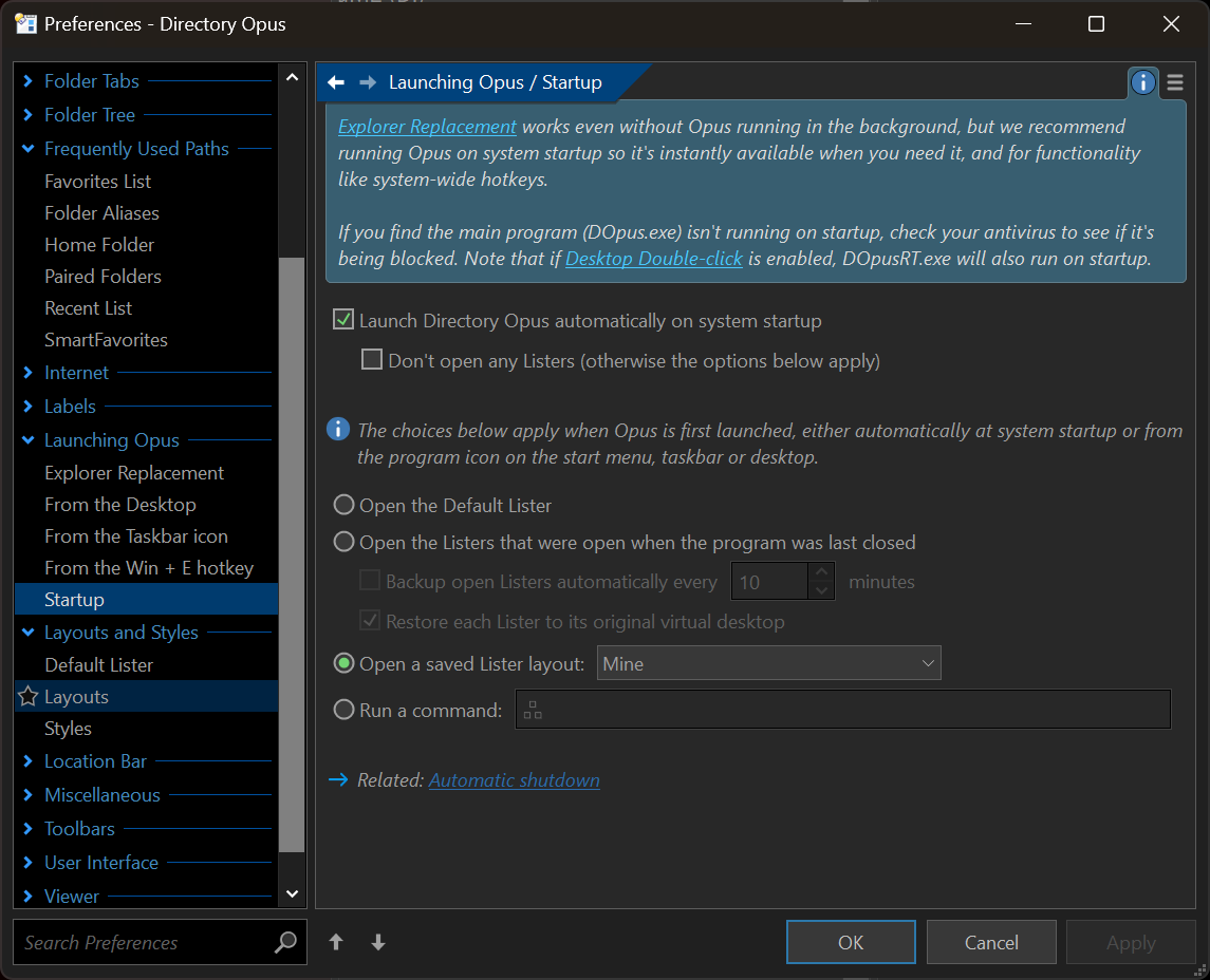

Please show a screenshot of Preferences / Launching Opus / Startup.
Normally, you would want that to open the Default Lister, not a layout.
With the configuration you have currently, you'd need to save over the "Mine" layout to change what opens.
I had that set but it still opened incorrectly. I changed it to this to fore it to open Mine but it doesn’t.
On boot up of windows it opens an incorrect view by default, I have no lister saved for this view. If I quit and reopen Dopus it opens to “Mine” lister.
