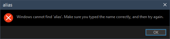

Getting nowhere with this. Not understanding the Mid() reference. This is what I have:
Path.dcf (2.9 KB)
When attempting to use the function, it throws this error:
Assume this is because the button type is set to Standard Function, which is purposely done to accommodate the @keydown arguments.
