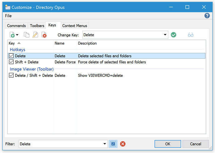

What do you see if you open Customize > Keys, then at the bottom make sure the [Z] icon is enabled, click on the filter and push the Del key:
I don't know how I managed this, but the additional 'command' line was there and checked as you can see and was checked. I unchecked it and the Delete behaviour now seems to have gone back to normal
What did I do to add this line (to stop me doing something whacko in the future)?
Fiona
It looks like you have either added the Image Viewer toolbar to your listers, or turned on the Always enable this toolbar's keys in Listers checkbox for the Image Viewer toolbar on the Customize > Toolbars tabs.
Many thanks; at least I know what I screwed up
Much appreciated - Fiona
