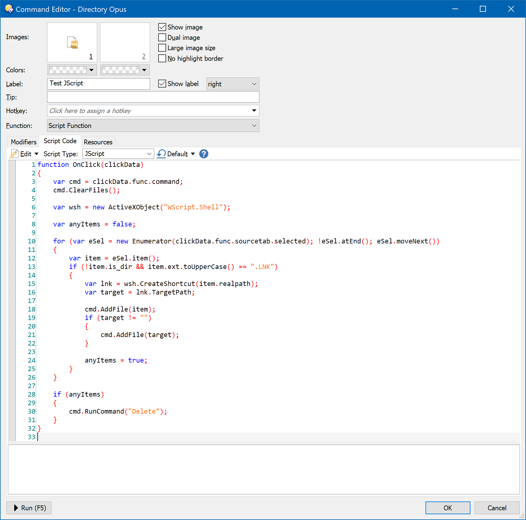

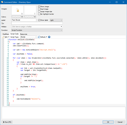

I would do it using a script-button like this:
function OnClick(clickData)
	cmd.ClearFiles();
	var wsh = new ActiveXObject("WScript.Shell");
	var anyItems = false;
	for (var eSel = new Enumerator(clickData.func.sourcetab.selected); !eSel.atEnd(); eSel.moveNext())
		var item = eSel.item();
		if (!item.is_dir && item.ext.toUpperCase() == ".LNK")
			var lnk = wsh.CreateShortcut(item.realpath);
			var target = lnk.TargetPath;
			cmd.AddFile(item);
			if (target != "")
				cmd.AddFile(target);
			anyItems = true;
	if (anyItems)
		cmd.RunCommand("Delete");

Thanks Leo, this is a really nice script and it works :+1:
