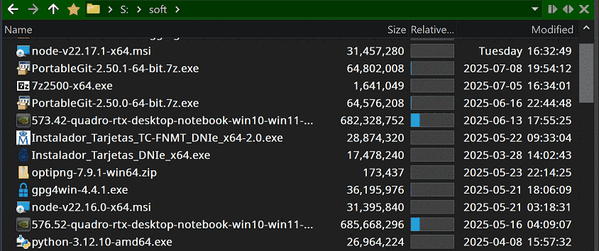

Well, below is the last stuff i did installed -- the last nodejs had some CVE fixes... but other than that, don't think anything else could have caused it.

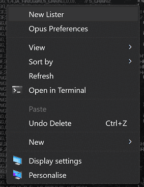

Btw, i just realized context-menu -> new-lister does have the same behavior than dblclick, failing to launch dopus (if dopus is already running, it does properly work opening a list in a new window)

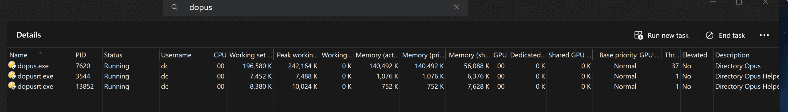

Well, checking through w11's taskman i don't see them elevated.

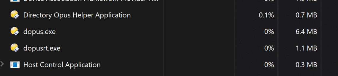

BTW, when using dblclick / new-lister, i see the "Helper Application" creating dopus.exe and dopusrt.exe, but then those processes disappear:

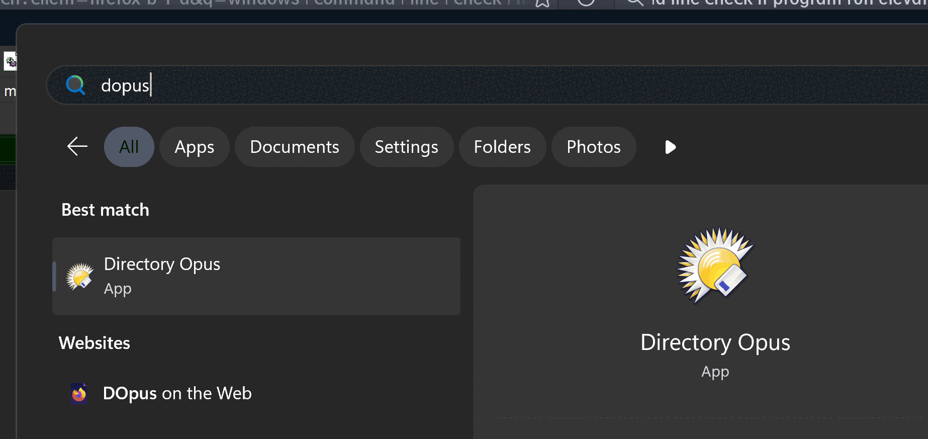

When i do use the Windows's StartMenu to launch the "dopus app" ...

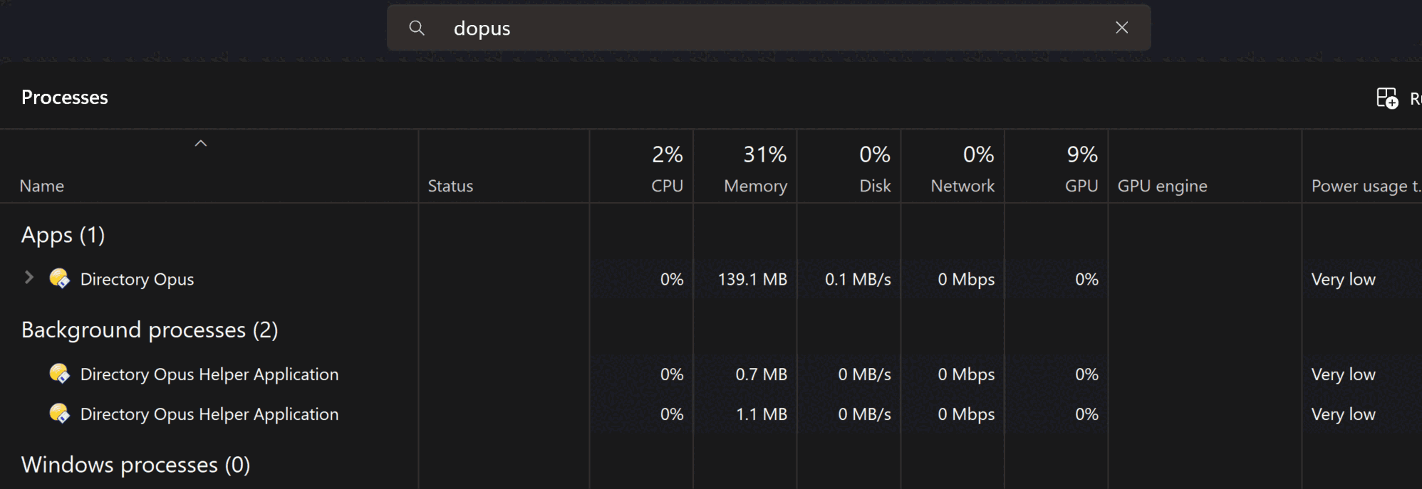

... dopus is launched normally, but creating an additional helper (dopusrt) process (as already seen on the first screenshot)
is this normal? i don't remember how it was in the past, but looks like if the former "dopusrt" is crashed or something and a new one launched (?)
That's normal.
