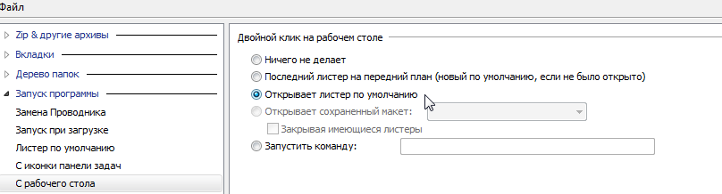

In the settings I have:

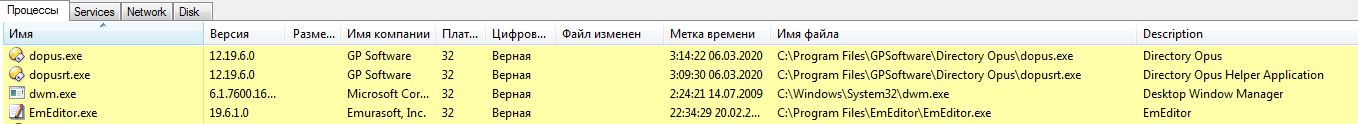

The task manager also has:
