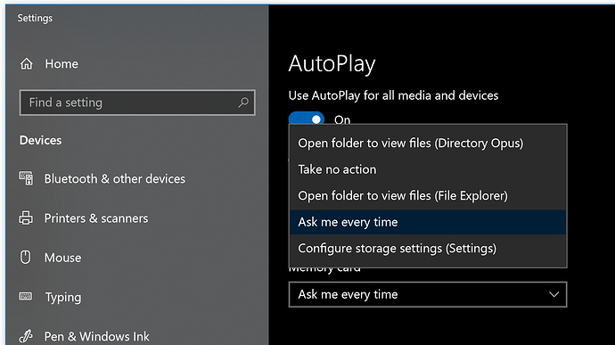

FWIW, I'm also on Windows 10 1803 and still see this, if I turn autoplay back on:
I see this under Settings:
I don't think I've done anything extra to get to here, since I don't usually use autoplay and had it turned off entirely until now.
